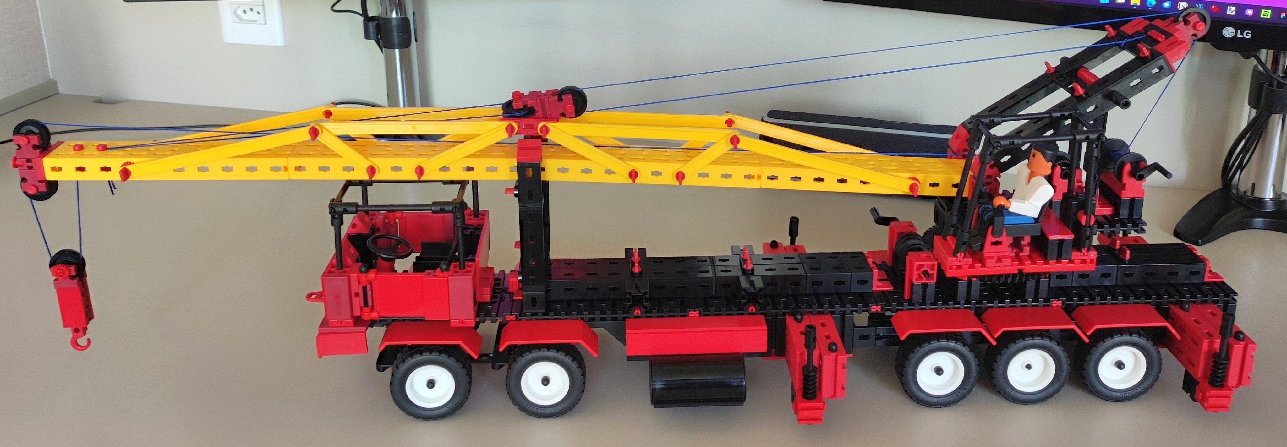

Just a quick note to let you know the current state of things. I've built all models from Super Trucks, except the truck with trailer. Here's the model I want to retrifit, the crane truck (Autokran):
crane truck.jpg (786.1 KiB) 35 mal betrachtet

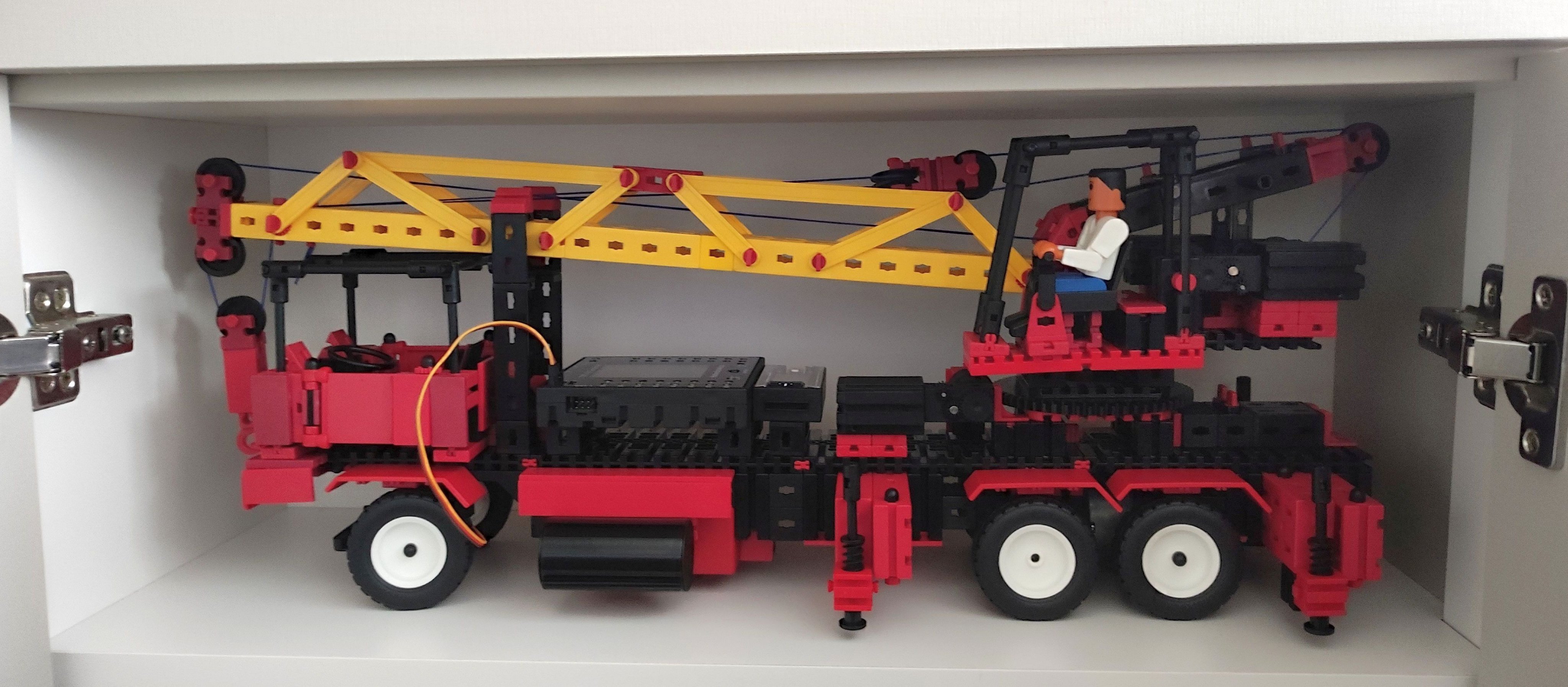

At 78 x 19 x 26, however, it's way too big to fit inside my currently available storage space, so I made a "pocket" version:
You can already see the TXT4, my custom ESP32 module and the motors. There is also a servo wire: because the TXT4 has only 4 motor outputs, the steering must be servo-controlled. The red battery can be partially seen behind the black tubular sleeve. Next step: wiring and software. We'll see how it goes...
Best,
Rubem
