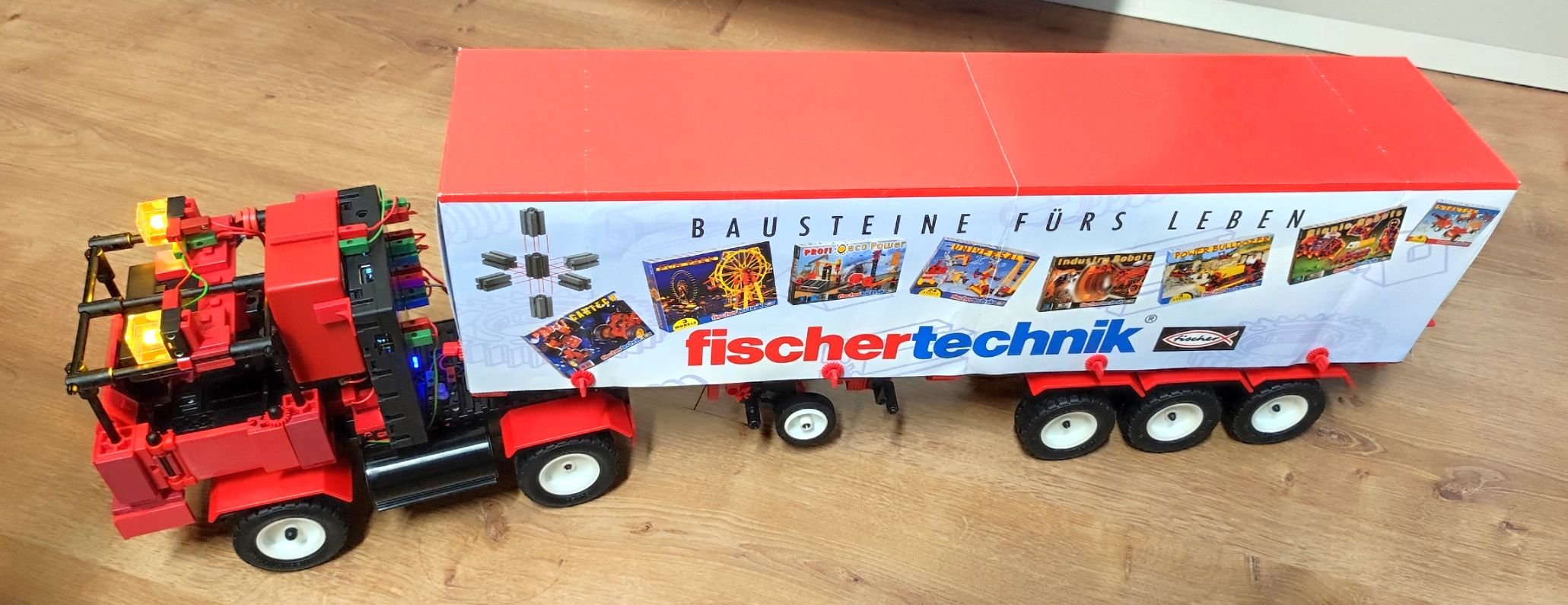

Here's the articulated truck:
Articulated truck.jpg (262.5 KiB) 42 mal betrachtet
The model travels quite fast, because despite it being around 50 cm long, the semi-trailer is quite lightweight. The total length is around 66 cm. But operating in reverse via the remote does not quite work: the angle between the tractor unit and the semi-trailer just increases until it cannot turn anymore. I'm not sure driving trucks is among my best abilities :D
The old-style ft graphics will please some of you, I'm sure!
Warmest regards,
Rubem
