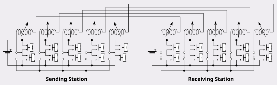

Thanks for your answers and compliments. @Cheorl, you are right: The photograph seems to depict a model with an earth (or return) wire added, possibly to be able to rotate needles individually so that it can send additional codes. My model, however, uses just five wires like in the schematic:
I'll try to change the title anyway, and I'll be adding more photos soon.

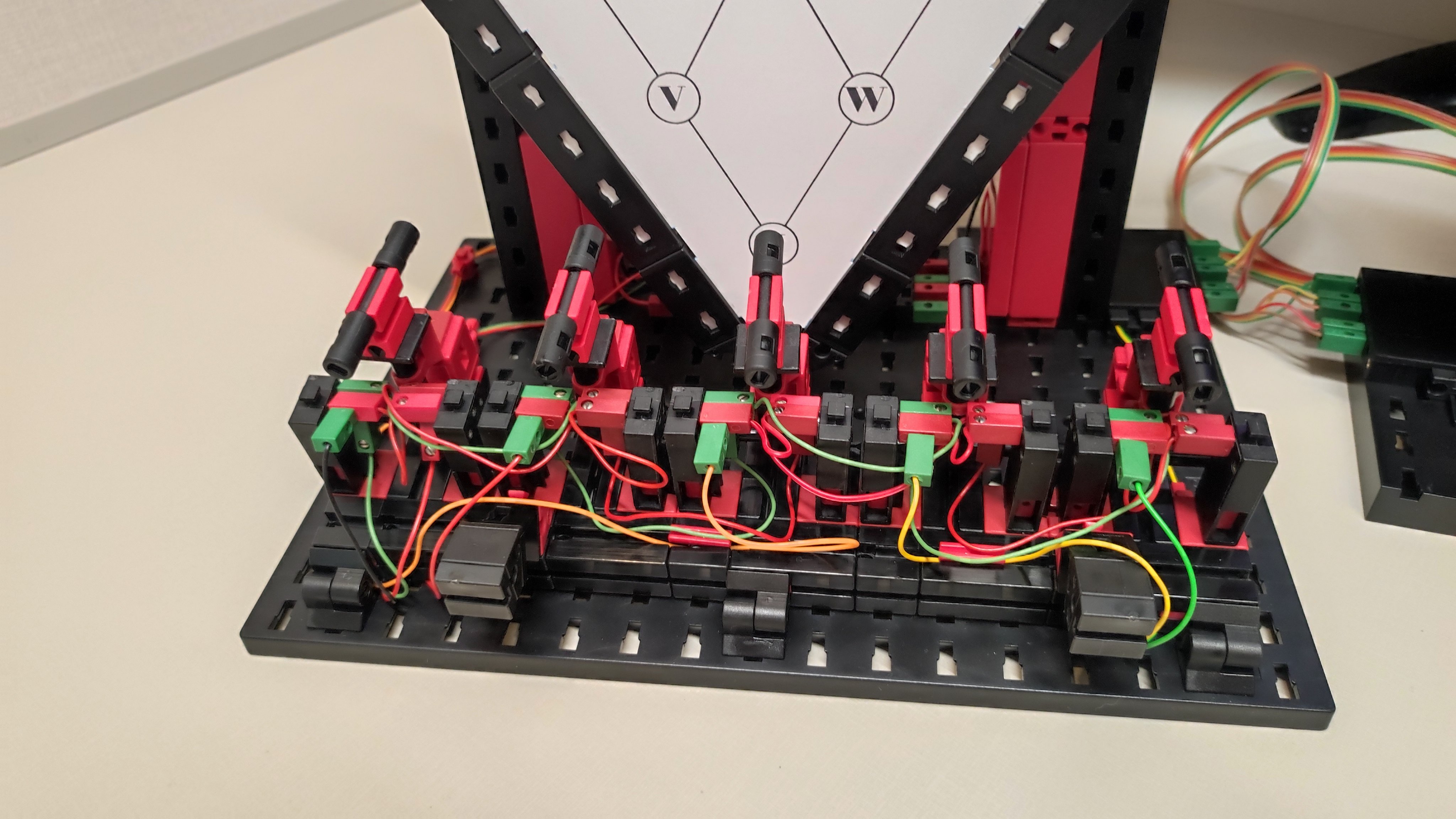

Here is a photo of the receiver (still on a plate 500) with the front panel removed. Harald, hopefully you can see that the connectors 15 with clips act as stops. And you added a good question: I don't hear any hum. Maybe because the switches are on just for short periods (less than a second)?

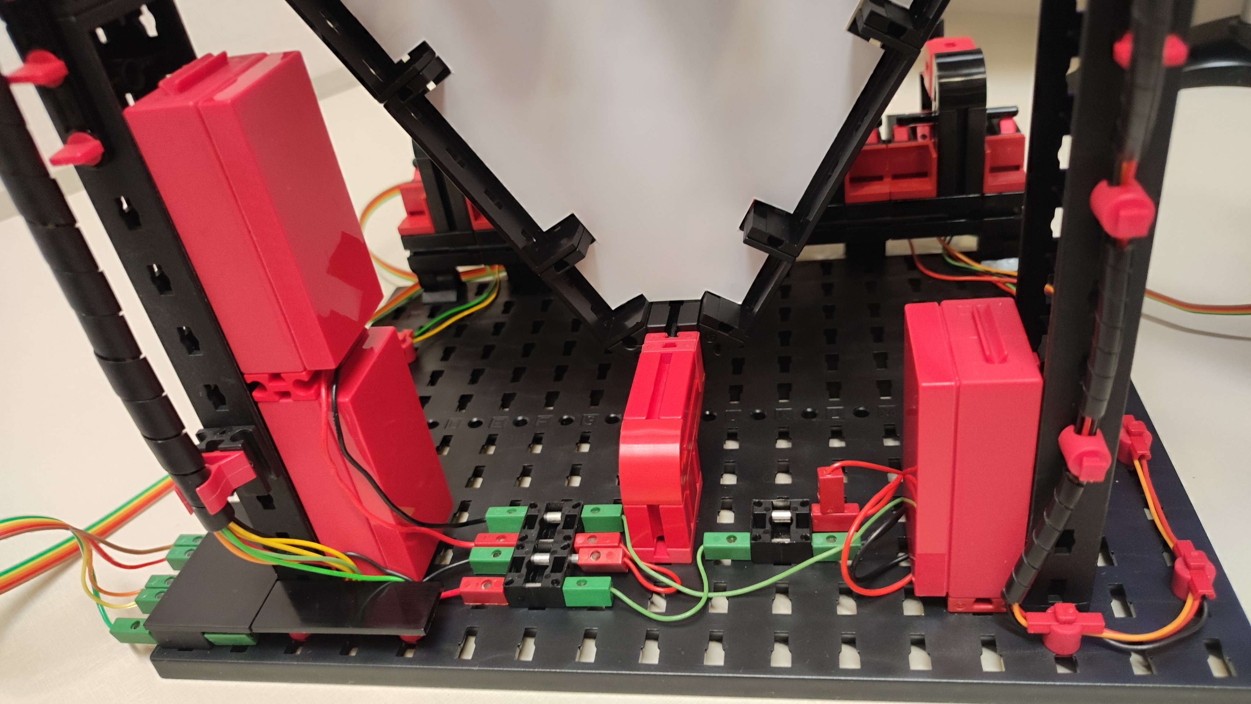

Here is the back of the transmitter showing the batteries:

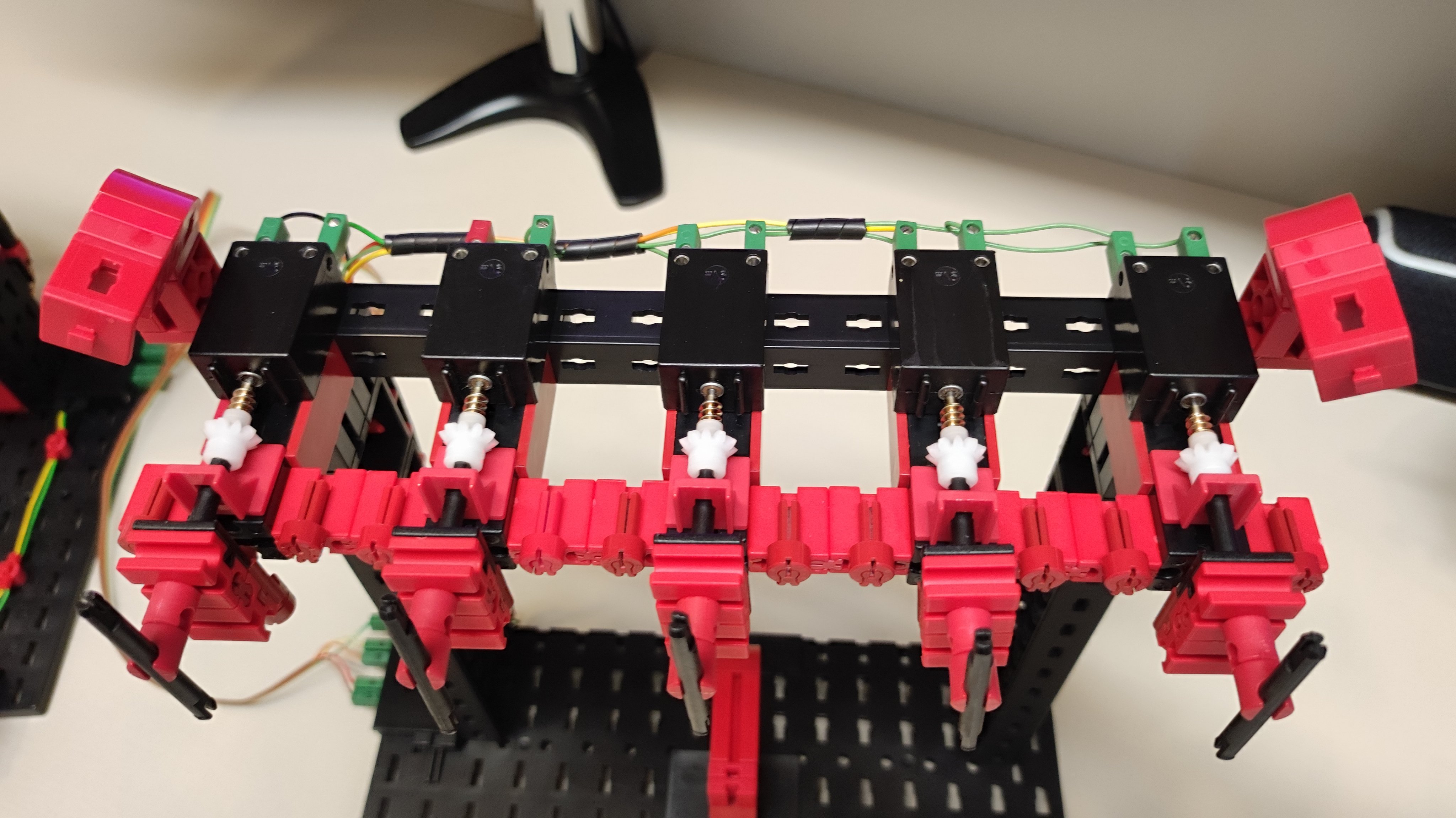

Here is the swiveling switch panel in the storage position:

Das Prinzip verstehe ich aber noch nicht. In Deinem Schaltplan scheinen mir mit den gedrückten Tasten 4 Motoren in Serie geschaltet zu sein.
Wie soll das funktionieren? ist das eine Art Schrittmotor-Betrieb für die Motoren oder laufen sie synchron und wenn abgeschaltet wird, bleiben sie an der gleichen Stelle stehen?
