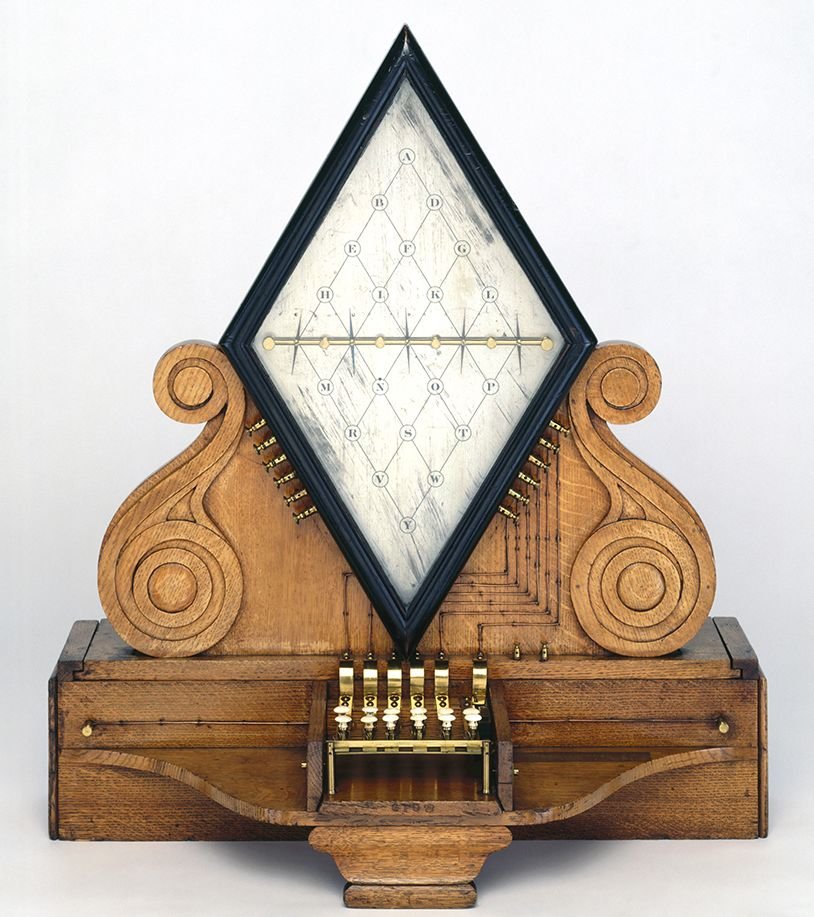

Some time ago I came across a Wikipedia article describing a fascinating invention that is obsolete now but was revolutionary in the 1830s: the Cooke and Wheatstone Telegraph. It worked by rotating needles via electromagnetic coils so that they pointed to letters on a dial. They made several models, but the most famous one used five needles. The transmitter and the receiver were interconnected with five wires, one for each coil, over several miles.
Cooke and Wheatstone Telegraph.jpg (127.05 KiB) 22 mal betrachtet

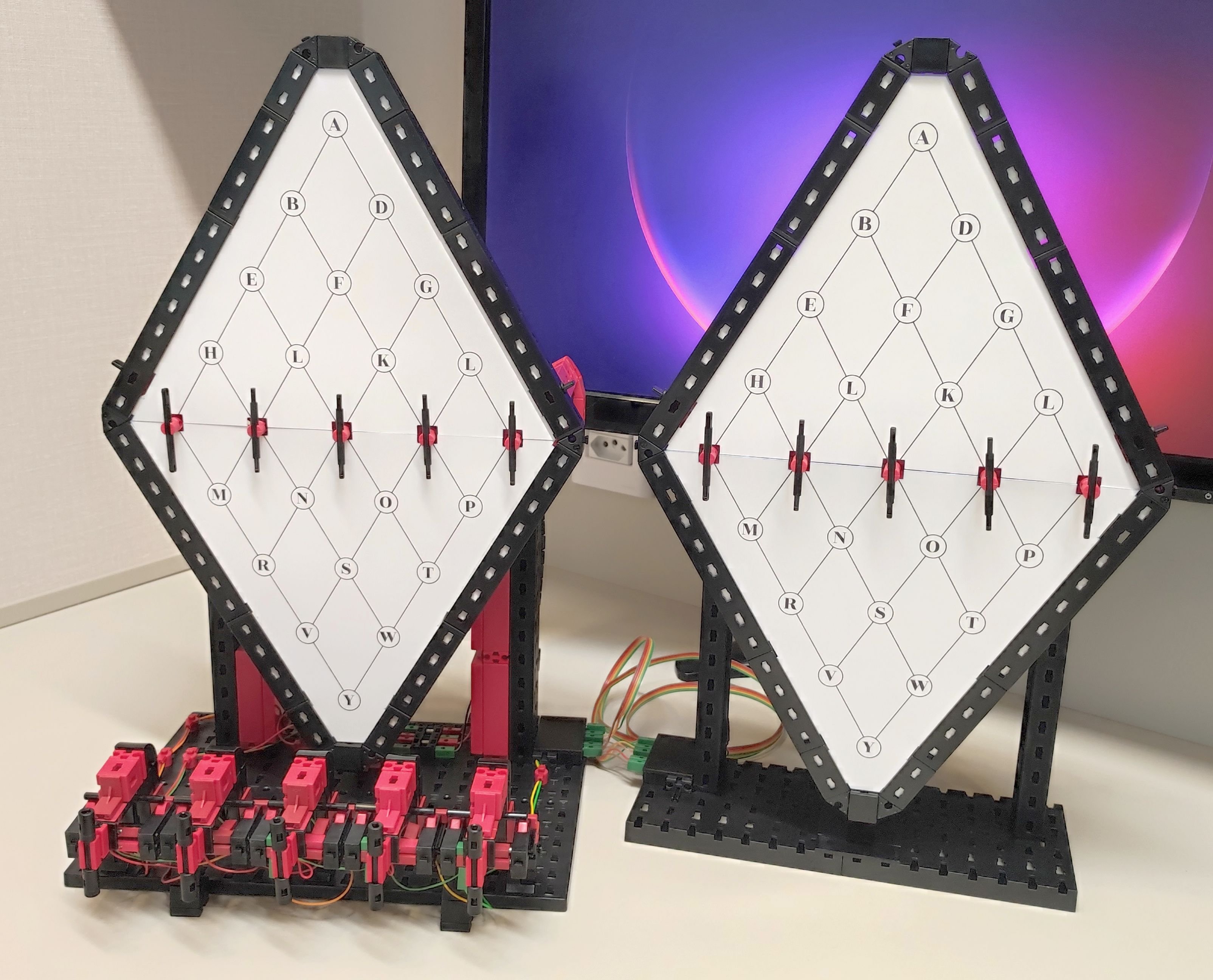

The article describes the device thoroughly, and it even includes a very nice schematic. A faithful copy would require ten electromagnets and ten fixed magnets connected to the needles, but I realized I could make it work with mini-motors. The principle worked, so I set out to build a complete model. It has one simplification: the model is unidirectional, that is, one unit is always the transmitter and the other is the receiver. I could made it bidirectional (i.e. half-duplex), but the wiring would require a lot of extra labor. It looks like this:
telegraph model.jpg (788.54 KiB) 22 mal betrachtet
In the original, two buttons must be pressed for a character to be transmitted. I added rotating handles to press the buttons, both to avoid short-circuits (which are very likely to happen otherwise) and to make transmission more user-friendly. Turning a pair of handles each time drives two motors on the transmitter and two on the receiver, sending one character. The whole switch assembly can be pivoted for easier storage. The panels are printed on 240 g paper and have lines, circles and typography similar to the original. Five needles give only 20 characters; I decided to copy the original English layout (which omits the C, J, Q, U, X and Z, so it can't quite spell "fischertechnik" :sad:). Perhaps some of you will try a German version with different letters? A bigger, 6-needle model which would allow up to 30 characters.
A classic ft challenge: how to drive a snap-in axle 130593 directly from a mini-motor? I used white differential bevel gears 31413 (like in the roller coaster model). The connection is not very solid, but it works. The motors are driven by three 9-Volt batteries connected in series, which gives around 6.75 per motor. With four batteries the motors may turn too fast and the gears might slip.

Der Artikel beschreibt das Gerät ausführlich und enthält sogar einen sehr guten Schaltplan. Ein originalgetreuer Nachbau würde zehn Elektromagnete und zehn feste Magnete benötigen, die mit den Nadeln verbunden sind. Mir wurde jedoch klar, dass ich das Ganze mit Mini-Motoren realisieren könnte. Das Prinzip funktionierte, also machte ich mich daran, ein vollständiges Modell zu bauen. Es hat eine Vereinfachung: Das Modell ist unidirektional, das heißt, eine Einheit ist immer der Sender und die andere der Empfänger. Ich könnte es auch bidirektional (Halbduplex) gestalten, aber die Verkabelung wäre sehr aufwendig. So sieht es aus:
[Bild]
Im Original müssen zwei Tasten gedrückt werden, um ein Zeichen zu senden. Ich habe Drehgriffe zum Drücken der Tasten hinzugefügt, um Kurzschlüsse zu vermeiden (die sonst sehr wahrscheinlich auftreten) und die Übertragung benutzerfreundlicher zu gestalten. Durch Drehen eines Griffpaares werden jeweils zwei Motoren am Sender und zwei am Empfänger angesteuert, wodurch ein Zeichen gesendet wird. Die gesamte Schaltereinheit ist schwenkbar und lässt sich so leichter verstauen. Die Bedienfelder sind auf 240 g/m² Papier gedruckt und weisen Linien, Kreise und eine dem Original ähnliche Typografie auf. Fünf Nadeln ermöglichen nur 20 Zeichen; ich habe mich entschieden, das englische Originallayout zu übernehmen (bei dem die Buchstaben C, J, Q, U, X und Z fehlen, sodass „fischertechnik“ nicht korrekt geschrieben werden kann :sad:). Vielleicht versucht ja jemand von euch eine deutsche Version mit anderen Buchstaben? Ein größeres Modell mit sechs Nadeln, das bis zu 30 Zeichen ermöglicht.
Eine klassische Herausforderung für Fischertechnik-Fans: Wie treibt man eine Schnappachse 130593 direkt von einem Mini-Motor an? Ich habe weiße Differential-Kegelräder 31413 verwendet (wie beim Achterbahnmodell). Die Verbindung ist nicht sehr stabil, funktioniert aber. Die Motoren werden von drei in Reihe geschalteten 9-Volt-Batterien angetrieben, was etwa 6,75 Volt pro Motor ergibt. Mit vier Batterien könnten die Motoren zu schnell drehen und die Zahnräder könnten durchrutschen.
