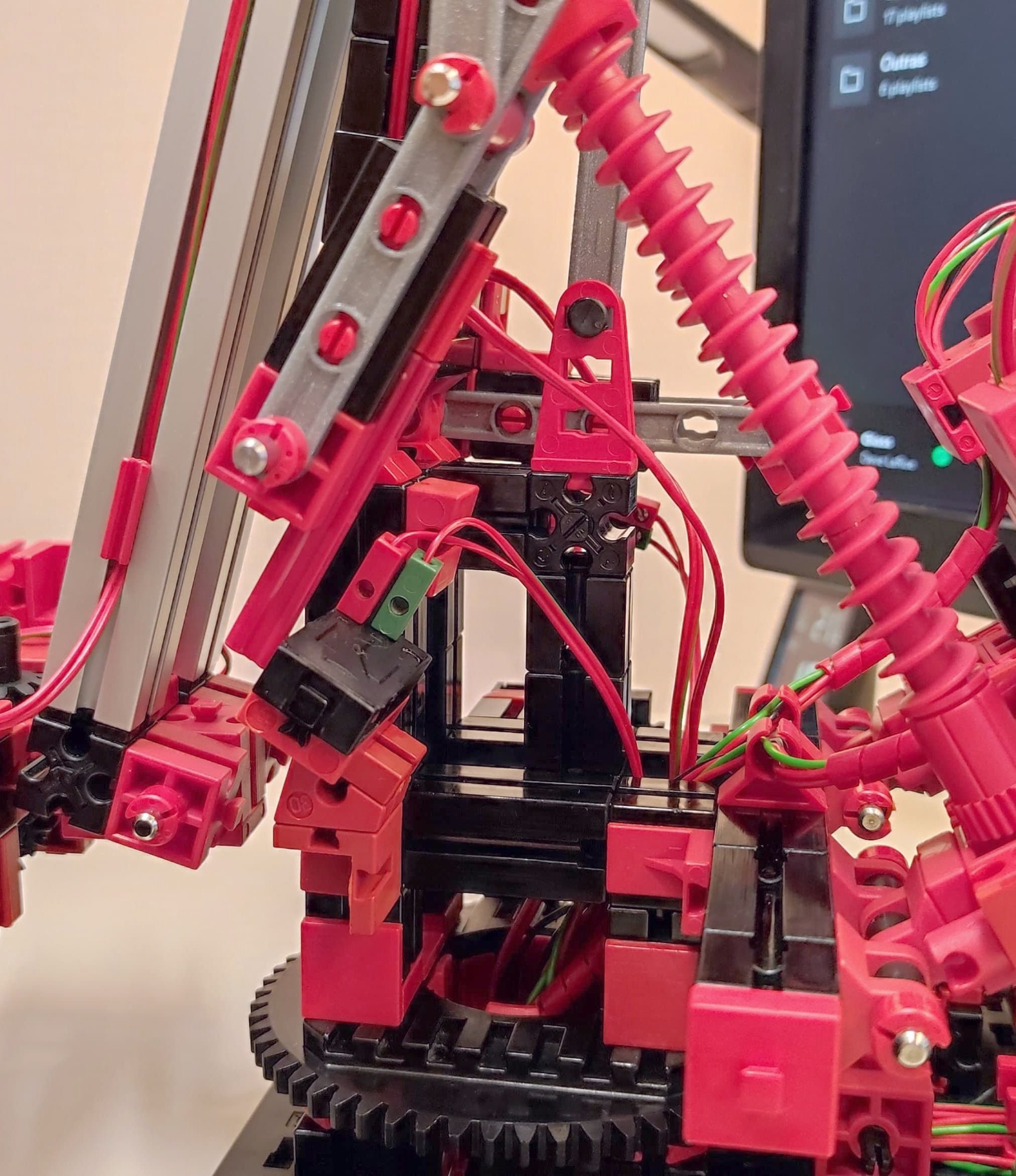

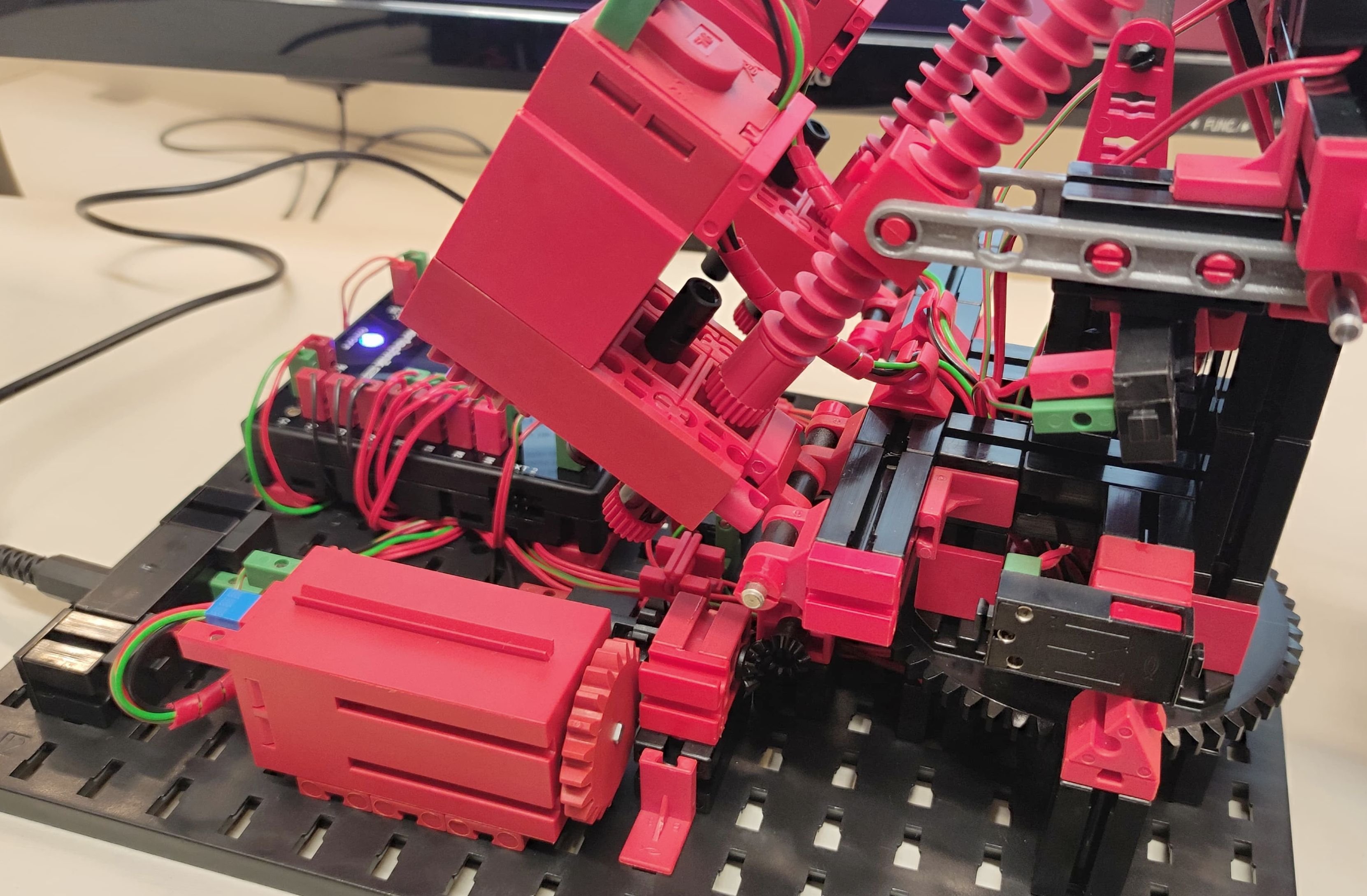

Beitrag von rubem » 27 Jun 2025, 23:44
Hi,
I managed to solve some things that were still bothering me:
- The motor responsible for the rotating turntable now also has a 2:1 ratio so it moves faster. As a side benefit, it is now fully contained in the main baseplate because I turned it 90°. The side effect -- it is noisier because of the added Z20 and two bevel gears.
- The arm motor supports are simpler and more stable.
- The controller now lays flat and cable routing is cleaner.
Motor assemblies.jpg (778.98 KiB) 1993 mal betrachtet
- The up/down arm home position was reversed. Now it is down, as it should be. My solution does not look so great IMO because I had to add several parts, but this does simplify the software logic.
New home position.jpg (488.78 KiB) 1993 mal betrachtet
Now, one problem still remains: It's not possible to know which side the arm must be rotated if it is not at the home position. Or is it? Do you have a ft-only solution for this?
Cheers,
Rubem

Benutzeravatar
PHabermehl
Beiträge: 2574
Wohnort: Bad Hersfeld
Re: 1986er (1985er) Trainingsroboter-meine Version
Beitrag von PHabermehl » 28 Jun 2025, 00:17
Hi Rubem,
"home" is only a matter of definition.
Your rotational home position is the center position, so you can turn both left and right from the home position.
My solution would be straightforward. Set the home position to a physical end stop of the axis so you can only turn in one direction starting from home.
In other words - if you're not at home, there's only one direction to go.
At least this is how I solved it when I built my Trainingsroboter clone...
Kind regards,
Peter
viele Grüße
Peter

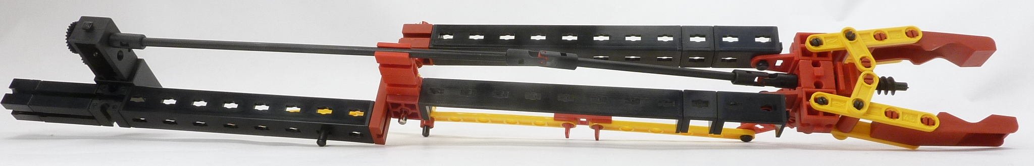

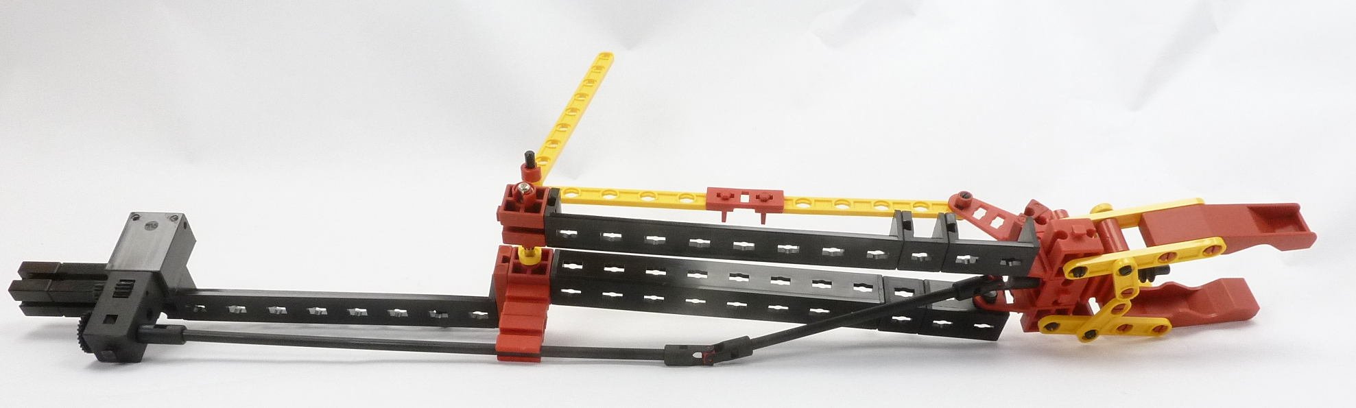

hier sind die Fotos, die ich damals vom Greifarm gemacht habe. Die Grundidee war, den Motor als Gegengewicht zu verwenden. Der Arm ist also ohne Last komplett ausbalanciert. So kann der Roboter auch mit den S-Motoren ohne Schneckengetriebe schwerere Lasten heben. Außerdem sollte er verschieden dicke Werkstücke heben können, um die Türme von Hanoi umzustapeln.
Viele Grüße
Thomas

Hello Thomas,
This is a very nice lightweight robot, and very cleverly constructed. Is there a video of it?
Thanks for sharing!
Rubem

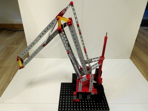

Hallo Thomas,
Klasse Modell, weil es effektiv ist und mit kleinen Motoren funktioniert.
Für den unteren Arm wäre auch ein Gegengewicht erstrebenswert.
Dein Modell und ein Blick auf die Schreibtischlampe haben mich zu folgender Studie inspiriert:
Die Zugfendern entlasten die Motoren. Die langen Schneckenspindeln sehen zwar nicht elegant aus, verleihen dem Teil aber einen großen Arbeitsbereich.
Viele Grüße

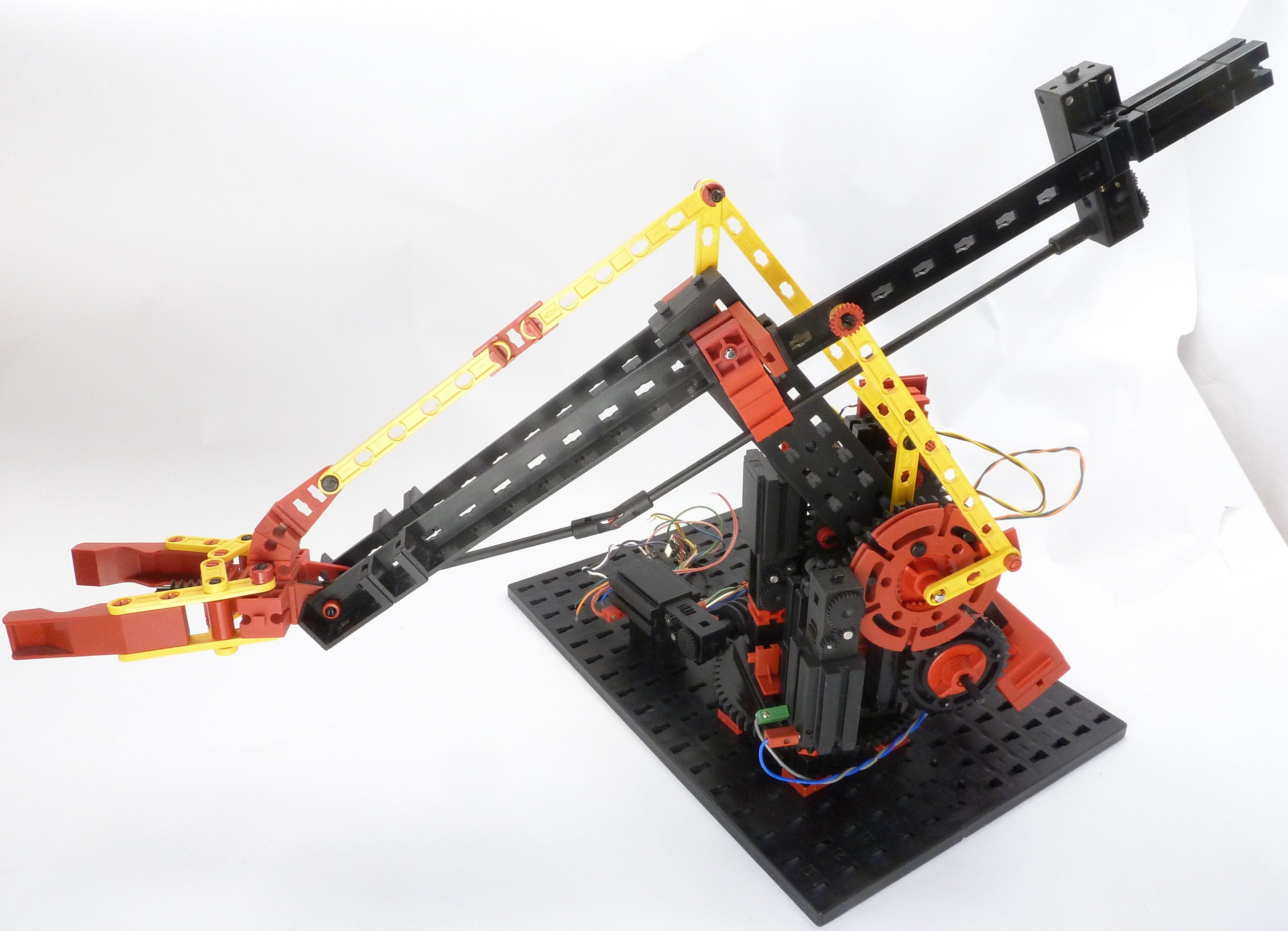

Hallo,
ein Video habe ich nur zu dem Roboter mit Laufschienen: https://math-meets-machines.de/Greifer.mp4
** a video clip exists just for the original version of the robot **
Beide Varianten (mit und ohne Laufschienen) haben für beide Arme Gegengewichte. Beim einen ist es der Motor, beim anderen ein mit Gewindestiften gefüllter Batteriekasten.
** in both variants there are counter weights on each of the two arms. One time the motor, the other time a battery box with weights. **
Viele Grüße
Thomas

Hallo Florian,
super Modell: Schreibtischlampe!
VIele Grüße
Thomas

Hallo Thomas,
Thanks for the link! Very nice indeed.
Rubem
