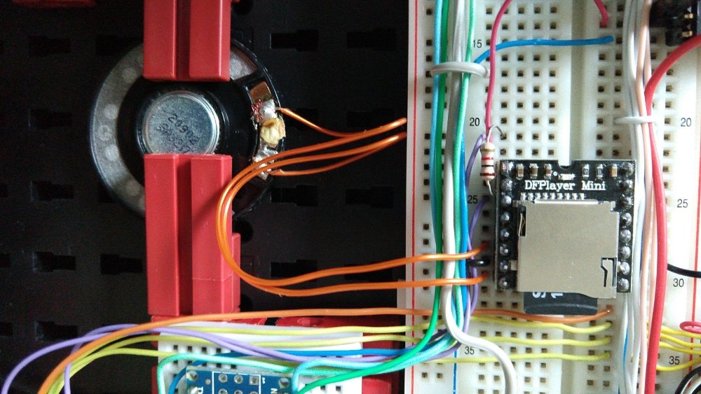

von rubem
Hi again,
So in the end I've purchased a very cheap (about €4.30) DFPlayer clone and, after some code tweaks, finally my project can enjoy any number of high quality sounds with a decent volume. That's bye-bye for the ft sound modules, unfortunately. The DFPlayer comes with a SD card slot, USB pins (didn't try those out yet), accepts both WAV and MP3 files up to 48 kHz and can drive a small speaker directly. It uses a simple serial protocol, any two Arduino ports can be used via a 1 kΩ resistor. Here it is, with a speaker taken from a discarded JBL headphone:
For those who'll like to experiment with this little board, here's the reference: https://wiki.dfrobot.com/DFPlayer_Mini_SKU_DFR0299. In the first tests the sample Arduino code worked fine by itself, but in the real world, i.e. with several things (like asynchronous delays and I²C) happening at the same time, the Arduino froze randomly after just a few sounds. The solution was to reduce the DFPlayer timeout from 500 to 50 or less. This is not documented anywhere, though. I found it by trial and error.
