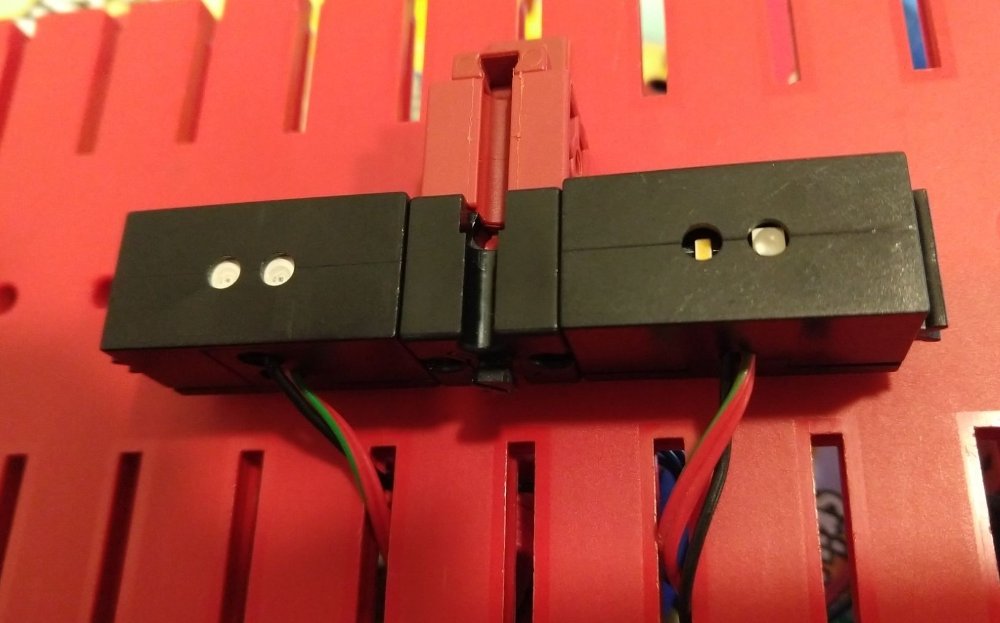

Hi all,
I already had an ft color sensor and I ordered a second one from the same seller. This seller has semi-new fischertechnik parts from old schools stock, but she doesn't know much about the parts themselves. I noticed that the LED and the phototransistor/photodiode look different from what they should look like, and the LED is white instead of red. Also the wires come from a single hole in the casing. Look at the photo below, the unknown sensor is on the right:
Two sensors.jpg (68.35 KiB) 2411 mal betrachtet
I can't tell anything about how the sensor reacts I didn't test it yet, I just lighted up the LED. The ft database does not mention another part number either (I looked for "Farbsensor").
Is this an old version of the color sensor? Is this a color sensor at all? Any help would be much appreciated.
Thanks,
Rubem

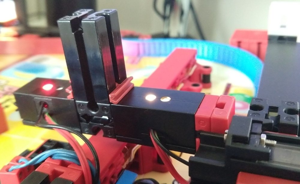

No ideas about this sensor yet? Well, I decided to make some quick tests with the two different sensors and got some interesting results. Here is my test setup, where you can already see a few parts of the pinball table I'm building:
test setup.jpg (88.12 KiB) 2270 mal betrachtet
The sensors are driven by a 9 V power source and their outputs are attached to an Arduino Nano. Here's the relevant code:

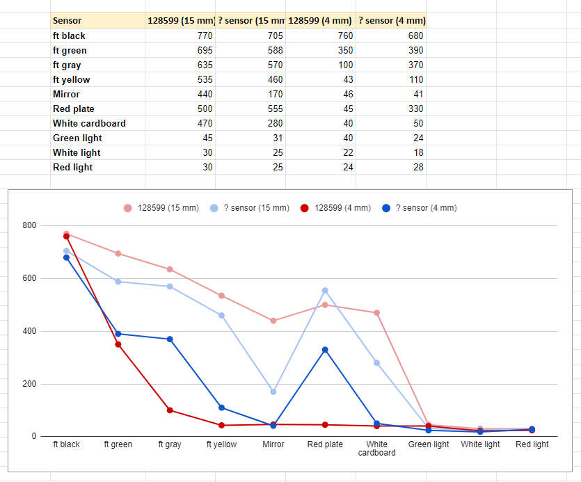

"Red LED" and "white LED" are just a way to refer to the two sensors (128599 and unknown, respectively) according to their LED colors. I used two distances for the measurements, 15 mm (a block) and 4 mm (the 31982 spring cam you can see in the above picture). Then I copied some typical values to a spreadsheet and plotted the results to a line graph:
Lower values mean more luminosity. The very high values were obtained by illuminating the sensors directly with a 3-color flashlight. Even with my inherently very imprecise measurements, it seems that the unknown sensor — which is symbolized by the blue lines — has a very different response curve from the "normal" sensor with the red LED. Its range of values is not so useful, the curve falls very abruptly and there is an obvious non-linearity with the red hues. I still hope I can use it to detect the steel ball, however. Otherwise I'll have to use yet another non-ft sensor for it (I already use several).
Still want some ideas, especially if someone has some experience with this uknown / older sensor.
