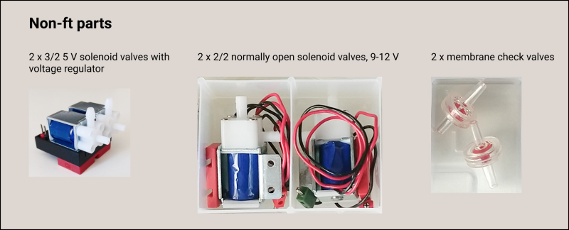

The two small 3/2-way 5V solenoid valves behave similarly to the ft ones. I've included a voltage regulator on each and now I can operate them from 9V. They work well with the TXT or directly via a push-button. I'm also using 2 membrane check valves (shown above) between the compressor and the solenoid valves so that each one has its own separate air reservoir (a blue cylinder). I'm not using the big 2/2-way solenoids for now.
I don't have any red pneumatic cylinders, so I'm using an old 45 mm Festo cylinder with spring for one flipper. It works well. For the other flipper I used a leaking Festo cylinder 45 which I've pried open (someone already did it in the past, it had a lot of glue), cleaned it up very carefully, inserted a (different) spring and sealed it back with hot melt glue so I can work on it again if necessary. It has good performance, but it extends a bit less because of the different spring. Playable, but not great.

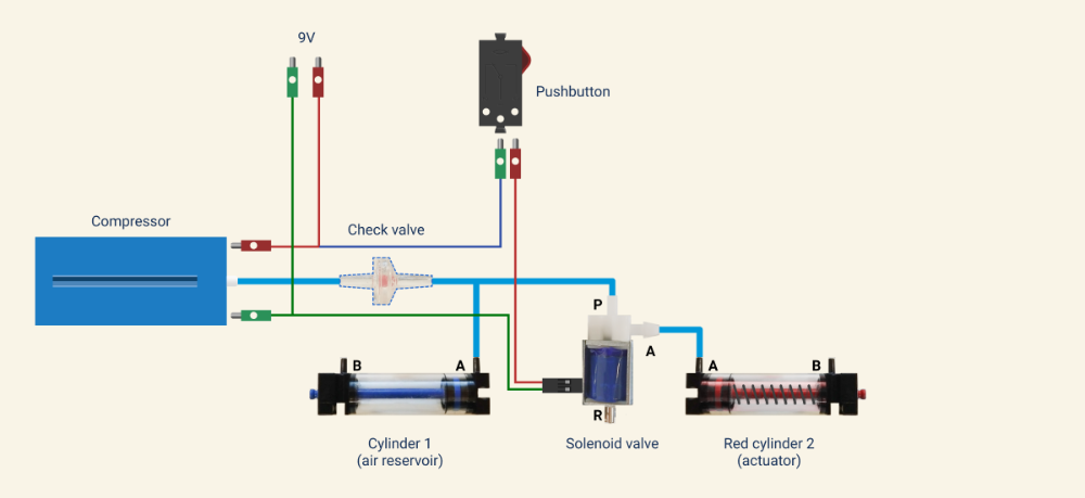

I'm back to the experiments with pneumatics for my pinball table. I feel more newbie than ever :cry: I supose I understand that a conventional circuit (e.g. from the ElectroPneumatics kit) should be like this:
Conventional circuit.png (84.87 KiB) 34180 mal betrachtet
(I intend to use two check valves so the air reservoirs are independent for each flipper, I hope it makes sense.)

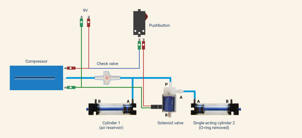

Of course this circuit only goes forward, so I've tried this:
Failed circuit.png (104.81 KiB) 34180 mal betrachtet
It goes back and forth, but it's ridiculously slow in both directions. Of course this is not what I need. I suppose that once I get it right, I'll want to move the actuator back just for some half second or so, then turn off both solenoids. Anyway I need your help here! I've even created an empty circuit with labels:

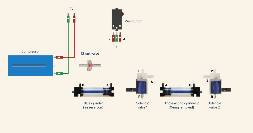

Empty circuit.png (101.79 KiB) 34180 mal betrachtet
Thanks for any help,
Rubem

I would say your circuit is perfectly correct and just wonder why you connected the right valve *before* instead of after the check valve. Why not put both behind it? What is the sense of the check valve? You may as well just remove it, I guess.
Good luck,
Stefan

Yes, the check valve is optional at this point. The idea is to create two separate air reservoirs, one for each actuator. I've already tried it like you say (below), but the results were the same: the actuator moves slowly in both directions.
Failed circuit 2.png (99.78 KiB) 34074 mal betrachtet

this sounds strange to me. Could you please try
- leaving the air reservoir away entirely,
- use a larger air reservoir (one of the fischertechnik parts) and, more importantly, feed the air into the reservoir from one side and use another pin as output (not possible with a cylinder), or, finally,
- double check everything for leakages, check that the compressor is running with 9V.
As this is one of the most simple setups you can use a cylinder with, this should run absolutely fine.
Regards,
Stefan

As a reminder, I'm not using fischertechnik solenoid valves, but the miniature 5 V valves shown at the first picture above 👆🏻 on the left. They are rated at around 0.5 bar. Maybe that's the problem?
Thanks again!!!

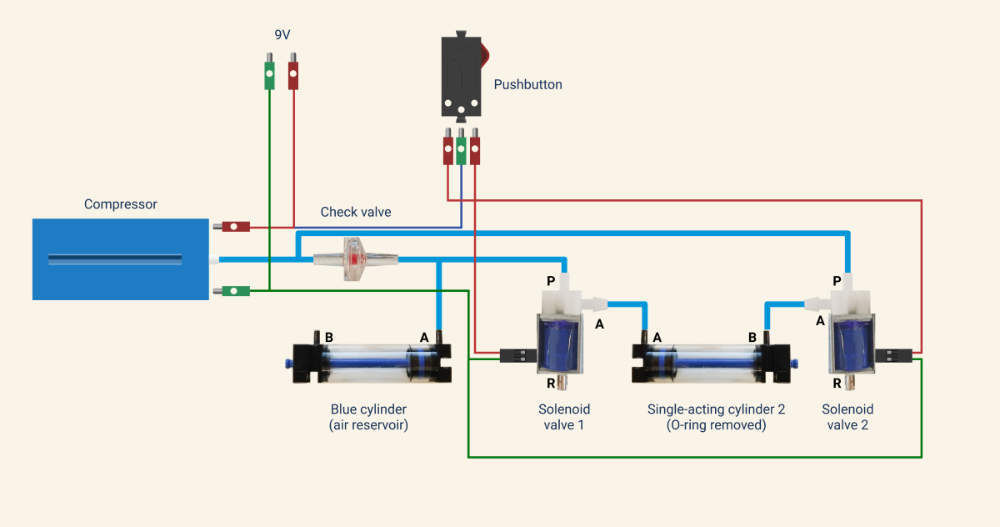

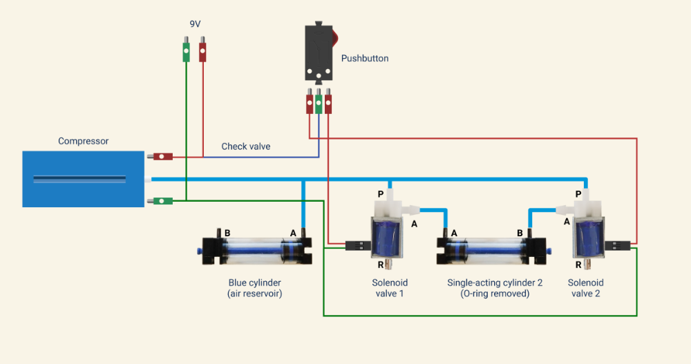

your circuit switches both solenoids at the same moment. When one feeds pressurized air into the cylinder the other one just starts to leave this pressure out to ambient. The differential pressure across the piston is less than you might expect, and thus the resulting force that moves it. Could you take a second pushbutton and try this, please:
One pushbutton powers valve 1 (and if this is powered, the air is guided into the cylinder, otherwise the cylinder is conected to ambient). Then you release this pushbutton and without force to the piston the cylinder stays were it is. When you now power the opposite valve with another pushbutton this will feed the cylinder opposite side with pressure and this time there is no high pressure that needs to be pushed out while the piston moves also. Maybe this speeds up your cylinder movement? But I am not sure if all the hose, nozzle and solenoid valve holes have sufficient diameter to allow for large volume flows at low pressure loss. At least you might want to kepp all air connections (hoses) as short as possible to minimize dead volume.
But what do you intend? A kind of pneumatic catapult to shoot one steel ball into the flipper? Check the basic physics behind, to figure out what speed the piston needs to move and then how much pressure it would take to accelerate this complete mass against the coulomb drag of the piston. I have the feeling that ft-pneumatics might not fit this bill. I once tried to shoot a ping pong ball up an inclined track using "Betätiger" https://ft-datenbank.de/ft-article/3218. Well, the Betätiger responds way faster to pressurization than a cylinder but for me it was no success, although.
Regards
H.A.R.R.Y.

@Stefan, yesterday I disassembled my previously opened cylinders (both blue and Festo types) and oiled them with silicon oil again. Especially the Festo one became amazingly smooth, but after just one day I can see the oil is not so effective. Perhaps this is not the right one? The local drugstores have something called "óleo mineral" (mineral oil) which is used for dry skin and... constipation. Is this the one I should try? Consipation makes a lot of sense, hahaha :D :D :D
@Harry, I experimented with the setup you suggested (thanks for the idea!), using a separate switch for the second valve. You are right, the forward movement is much faster if the valve are not operated simultaneously. It works well if switch 1 is pressed for a very short time, but the speed to move the piston back is much slower after pressing it around one second or more. It this case it generates an audible "pfffft". It seems more pressure builds up while valve 1 is open. The natural next step here would be to code this behavior with an Arduino, maybe adding a reed sensor to detect the moment where the cylinder is fully extended and limiting the time valve 1 is kept open.
My pinball table is quite similar to the one in the Electropneumatics kit and has the same size. The steel balls are identical to ft's (12.7 mm diameter) and I suppose they weigh just the same. (Edit: the seller just answered me, it's around 8.4 g.) However I don't have the original valves, cylinders and hoses (I'm using 2x4 silicon hose). The hoses between the valves and the cylinder are around 10-12 cm, that's much shorter than in the Electropneumatics kit (30 cm).
