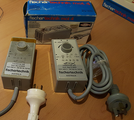

Hi,
I just received an unused mot. 4 812 power supply, the 30173 1975. The ones sold in Australia have an Approval label stuck over the original bottom third of the top panel, see the picture attached.
In Australia, we typical have 240 V ac. At my house its typically above 245 V ac and sometimes 250 V ac. (There is a local power substation close to my building)
In the picture, you can see there are two Mot. 4 812s. One has been used a lot the other is like new.
With 244.6 V ac input I get the following output voltages.
Output of like new mot4. 812 with no load
10.58 V ac
-12.12 to +12.12 V dc
Output of often used mot4. 812 with no load
9.47 V ac
-10.53 to +10.53 V dc
With Elektronik-Bausstein Gleichrichter + RBII for a 120 mA ac load then there is about 25 mV drop on the 812 ac outputs.
I am a bit surprised that they have all most a 10% difference in ac output voltage.
Has anyone measured their output voltages in Germany?
Does anyone know if the Australian mot4 812 is the same as the Germany version of the mot4 812, do they have the same transformer coil winding ratio?
Are there any schematic diagrams or pictures of the inside of one of these?
Thanks
Michael

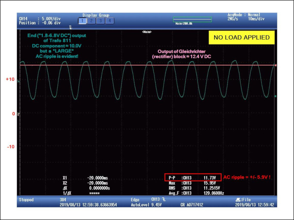

Here's a couple of oscilloscope images that show what is happening on the end (supposedly DC) output jacks of my 811. The AC side port is similarly high, but of course isn't rectified.
• In the first, there's no load. The output voltage seems too high and there is a LOT of AC ripple, +/– 5.9V on top of the DC component. I did attach a SIlberling Gleichrichter (rectifier block) which cleans up the ripple.
Trafo 811, max voltage on &quot;DC&quot; end port, no load
Trafo 811, max voltage on "DC" end port, no load

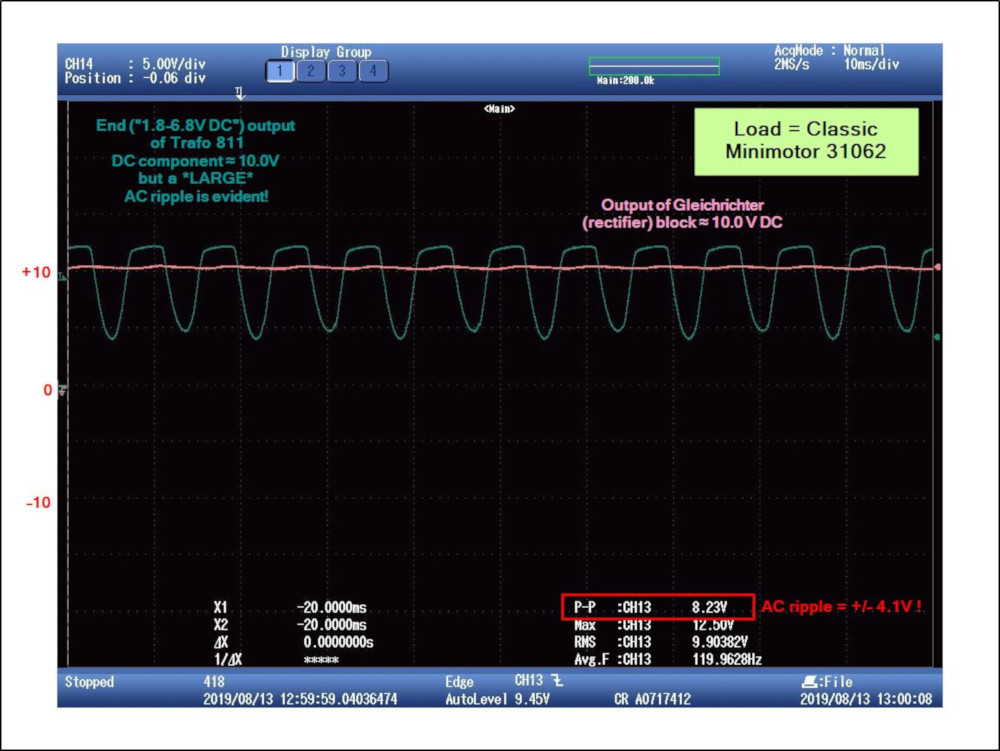

• In the second, I attached a classic era minimotor to the rectifier output. (not for very long, as I didn't want to damage the motor). You can see the motor load pulls down the voltage a couple of volts, but it's still pretty high, higher than seems OK to me for a classic vintage motor. Also, since the side (AC) port is similarly high, the Gleichrichter output without that motor load applied gets well over the 9.0 V +/– 20% (i.e. 10.8 V DC) specified in the design of the other SIlberlinge. And I don't want to smoke any of those!
Trafo 811, max voltage on &quot;DC&quot; end port, LOAD = classic minimotor
Trafo 811, max voltage on "DC" end port, LOAD = classic minimotor
My assumption is that there are two problems with the transformer:
1. The smoothing of the DC output is very poor, which I assume is because its internal 45-year old capacitor is no good. This should be easy to repair.
2. The output voltage is too high. I was guessing maybe some primary winding coils were shorted together, effectively reducing the turns ratio, but this is just a guess. I'm not sure if there could be any repair for this...
