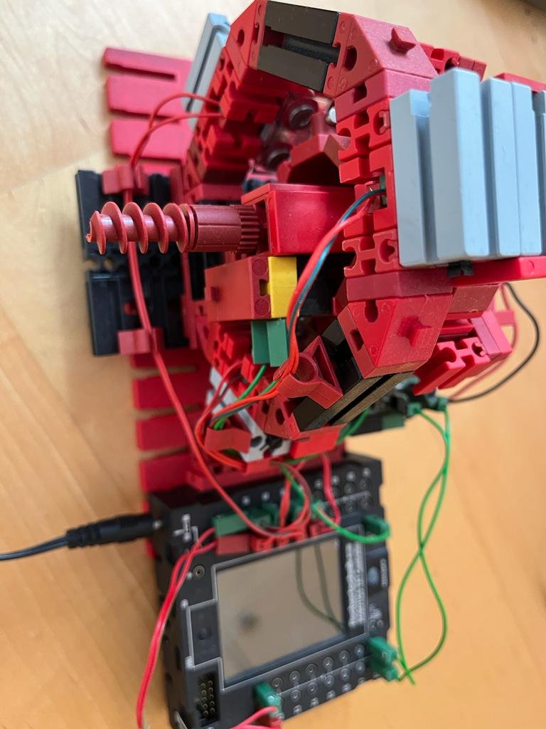

I have build this little e-motor, which could be suitable for the above mentioned experiment.
Machine
Machine
Also, I have created a gym environment for the e-motor using ftrobopy. The env passes the gym self-check and finally it can be used by Keras reinforcement learning eg RL2. - [Remark 08.10.2023: It turns out, that it is simpler to use e.g. stable_baselines3. Keras RL2 not maintained anymore.]
I did do that with my txt (not the txt4.0) using online mode, so there could possibly be a large audience, who have a txt and eg. studied or played around with ML with the classic virtual env like cartpole or mountain_car.
I used some existing ML code to test the environment and I passed properly (random) test data to the motor.
If the right data comes, the motor rotates.
As observation I provide the total turns per epoch and the rotation speed (if there was rotation).
Now, what next?
I expect it to be quite difficult to apply the right learning method.
A child can easily make the machine rotate. E.g. if one adds three power switches - one for each of the magnets - pressing one of the switches long enough, the machine does rotate up to 40 degrees. Now if applying power to the next magnet in sequence, the rotation continues.
The ML training, that I have found though, starts by randomly applying changing values immediately, without applying a single action for more time. This does not come with much result. It makes the e-motor vibrate, but that is it. Not much to learn from.
[Remark 08.10.2023:my fault: ML was just finding the "trivial solution" vibrating around the sensor - back and fro]
Certainly one could change the env, that only every second or so a new action could be applied but that would constraint rotation speeds achievable with the model.
If anyone interested I could provide the example env in gitlab or here.
[Remark 08.10.2023 - or at Sinsheim Convention, if I can still get a space - registered only now...]
