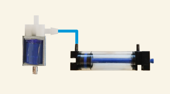

It is interesting to note that the piston offers some resistance when moving the it back by hand, even if it is simply connected to the valve as shown below and nothing else. The hiss is also there. Interestingly, there is no extra resistance (at least nothing I can notice) when moving it forward.

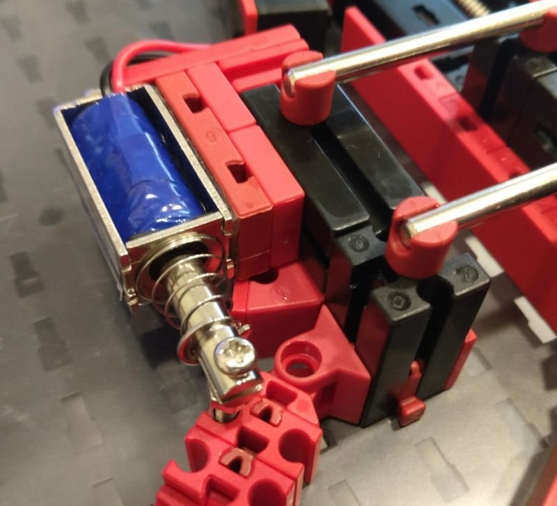

I'm back with a follow-up: I've given up on pneumatics for my pinball project. :o I've replaced the valves and cylinders with push-pull 6V solenoids (model JF-0530B) controlled by a simple Arduino program. The solenoids are very compact (the body measures 30 x 15 x 14 mm, so they fit perfectly in the ft grid), just take a look:
flipper assembly.jpg (72.72 KiB) 2666 mal betrachtet
After some experiments and several tests, I've decided to go with a power supply taken from an old laptop computer (19.5V, rated at 3.16A). Other power supplies, including one rated at 3.9 A, couldn't stand the two flippers being fired at the same time, they switched off for a couple of seconds. The driver is a good ol' L298N. The advantage is that it's rugged and short-circuit protected. It must be, the coil resistance is just around 5.5 Ω. I've fried a step-up regulator in the process...
The solenoids get full power for 50 ms and then the program drops the PWM duty cycle to about 15% (40 / 255) which is more than enough to hold the flipper up while the button is being pressed. The coils get lightly warm, but that's it. And the initial thrust is more than enough to propel the ball all the way up.
Anyway, the original subject of this thread is kind of lost, hahaha :D I'll create another one when I have more news on the pinball table. Again, many thanks for your ideas so far!
