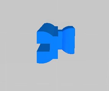

Fischertechnik matching pins. With these pins you can build almost all Fischer parts together. I use PolyMaker PolyMax PLA filament because it is very strong. The strength can be compared to the original FT pins.

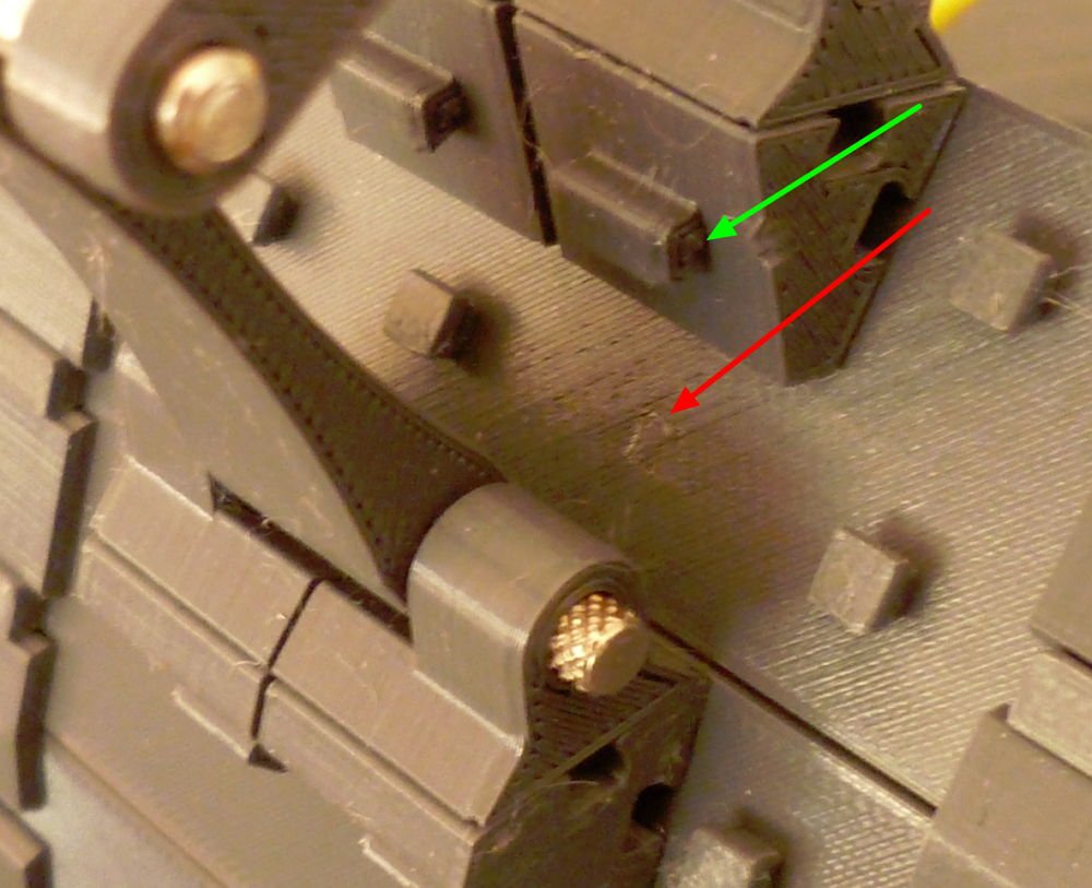

Hello Frans,
About your PLA filament. Do you have experiences with other materials as well? Are you able to compare to other PLA or PETG?
I am using mostly PETG, which should be stronger than PLA in general.
I created a 1:1 ft-compatible knob by myself and printed parts with PETG. The knobs are strong, but not as strong as original fischertechnik knobs. When using too much force, my knobs are breaking off! Never happened with fischertechnik
Sample:
Red Arrow: broken knob
Green Arrow: I prefer this type of knob; very stable, but of course the usage is not as flexible as original knob (90°)

Orientation plays an important role when it comes to stability of printed pins. If the pin is printed upright, you'll have less stability, as in FDM printing the bond between layers will always be weaker than within a layer. NBGer's broken pin seems to have bee printed upright, while Frans, judging from the stl files, seems to print the pins horizontally. Also, print parameters like temperature, cooling, and flow rate are influential here.
In my tests with a related design, I got much better results with PETG vs. PLA and a horizontal printing position. Yet, I did not achieve stability that was comparable to ft parts. So, Frans, did you run any actual tests on the stability of your printed pins in comparison to ft pins?

yes, I agree! orientation is important for stability!
but my example was a "Mounting plate 30x90". There is no chance to change the orientation!

NBGer hat geschrieben:
30 Dez 2019, 14:13
Yes, you are right. The only chance in this situation would be to print the pin as a seperate part and glue it in place, like this.

I haven't done a real force measurement but with the regular PLA they break down while with the PolyMax they have never broken down. The .stl files need to be placed in the right position with the printer software. Now they are vertical which is not good.
I don't use supports here. The print temperature is 210°. With a bit of Pelikan Pelifix glue they hold on to the bed during printing. I print them out in batches of 16 on the plate. PETG actually requires a heated bed and a higher print temperature. Less suitable for my FlashForge Finder printer.

von juh
So you're saying you are printing them in this Bild orientation and not in this Bild?

von PHabermehl
juh hat geschrieben:
30 Dez 2019, 14:37
But this example does not fit since it also ist printed vertically and relies on the layer adhesion.
My experience is that a slightly increased material flow (about two per cent) and increased print temperature (about upper limit of the material) help increase the layer adhesion.

von NBGer
maybe this would be a reasonable rotation for printing the item:

von juh
Yes, exactly.
