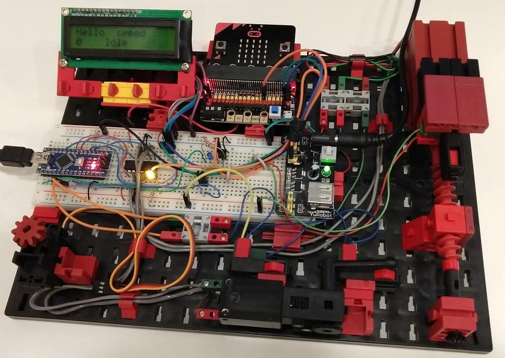

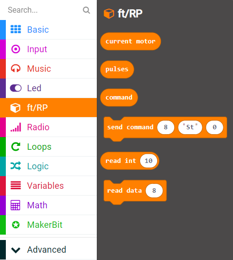

Hi everyone,
I'm working on a module to control two encoder motors and two servos via I2C. The idea is nothing new, but I want the module to do all the "heavy lifting" so the client code is kept as simple as possible. I'm using the micro:bit as a client, but of course any I2C-capable device should work (ftDuino, TXT, TX-Pi, etc.). One of the main reasons I like the micro:bit is because of MakeCode, it can be simple and powerful at the same time. I'm also quite comfortable with JavaScript, and I've quickly created a simple custom library to help me with my tests:
Custom microbit library.png (43.58 KiB) 288278 mal betrachtet

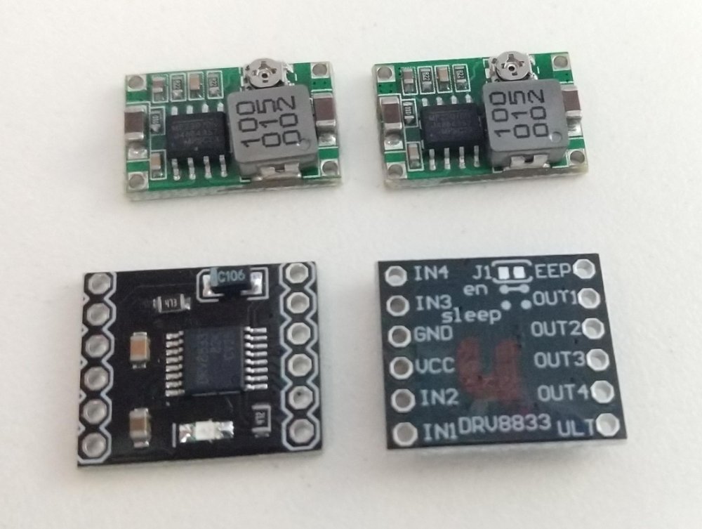

In terms of hardware, the module should be inexpensive and use components that are readily available. I plan to use an Arduino Pro Mini clone, a generic DRV8833 board (I'm using a L293D for now), and a step-down converter for the module. I also have hardware questions, mainly regarding I/O and power lines protection. But I'll leave those for another post. And I have yet to draw the schematics. Here's my test setup:
Test setup.jpg (133.27 KiB) 288278 mal betrachtet
What should this module do? At least in ft, encoder motors tend to be configured in a very standard way: A limit switch that sets the home position, two motor outputs, and the counter input. Another common configuration is to use a second limit switch to signal the end position and ignore the counter. I've already tested these and the program works, but I stumbled upon my own limited knowledge of the fine details of actuators, interrupts and the like. Therefore the counter precision is low because I'm only stopping the motor when the limit is reached and nothing else. No dynamic speed control, no PID. In the future also want to be able to move the two motors in sync, improve the speed control (torque is quite low), control the servos and maybe create a learn mode with position slots saved to EEPROM. My I2C commands are:
I'm no I2C specialist at all, so if there are some known standards I'll be glad to use them. The code is published in this GitHub repo. It should be simple enough for the wizards among you to read without even testing it, I'm sure. But of course testing is very welcome as well ;)
My main issues for the moment are: 1) Improving the motor precision; 2) A better way to send commands back to the micro:bit. AFAIK I2C is a multimaster protocol, but I'm not sure how to set up the micro:bit for it. For now I've used a pin to receive events from the Arduino (main.ts, line 38), but I think this is ugly and it also implies an extra wire between the module and the client.

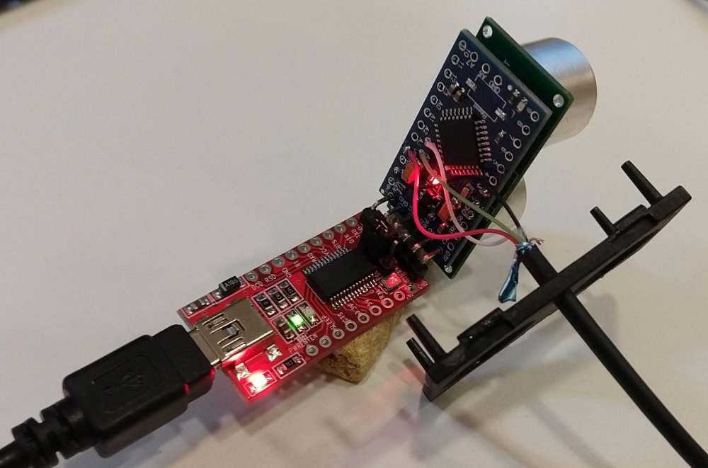

I've already created another DIY module using an old two-wire ultrasonic module as the housing. This is simple enough (see the code at my repo). I have other modules in mind too.
I'll be very glad if this is also useful for someone, I hope some of you like the idea.
Many greetings from Southern Brazil,
Rubem Pechansky

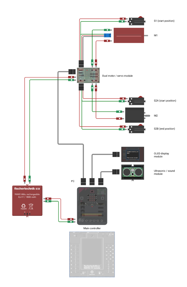

Perhaps I should have shown you this:

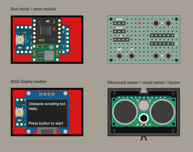

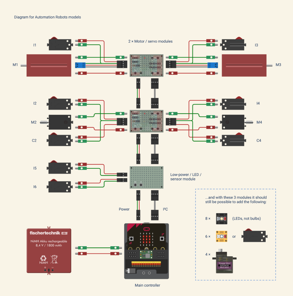

The idea is to make some small modules to use with ft. They must be simple to construct, inexpensive, and encapsulate enough functionality so they are simple to use as possible for the controller's standpoint. So I'll try to break this topic down into questions, in no particular order:
1. Encoder motors. How to support encoder motors with precision similar to the TXT (and possible other controllers)?
I really don't actually need anything the TXT or the community controllers do not do already. My goal is simply to be able to control ft models, and the precision I achieve with the TXT is more than enough for my needs. (I assume that's true for most fischertechnikers as well.) I don't own a ftDuino, but I've checked MoG's code at GitHub. At a quick glance there doesn't seem to be anything much special about encoder motors except counting impulses at breaking the motors, I didn't find anything about PID or deacceleration. Is the ftDuino precision similar to the TXT's? If it is, maybe I don't really need PID after all, I din't know.
@Jan, thanks for the links. I still plan to keep everything within my comfort zone, so this means... Arduino for me ;) I have a pair of geared quadrature motors that look almost identical to the ones you liked to, and I was using a pair of stepper motor holders (160528) with a drilled flat panel 31013 to hold them. (Of course you will use your 3D printer skills to make a top quality housing instead!) That was before I purchased 2 kits with original ft encoder motors, so the quadrature ones on the shelf now.
Also, motor synchronization is something that will be desirable, I wonder how the community controllers do it. Anyway, my results to date are not very precise, the counter always stops after the value I want (due to inertia, I believe). My DRV8833s arrived in the meantime, but I didn't test them yet, maybe they will improve this somewhat. I suspect my code is way too simplistic. This is the one area where I could really use some help...
2. Torque. How to achieve better torque with reduced speed?
I see this topic arises now and then at the forum. But to be fair that's not a priority for me now, it's just that it's a desirable thing for everyone.
> Unfortunately this all is written in German, But maybe you manage to get some idea of the inner workings of the motors and why your torque is so low.
@H.A.R.R.Y, thanks for the links, but they are way too technical to me. If dealing with it all is what I need in order to improve torque, I'll gladly leave it for now :) <off-topic> Unfortunately auto-translating PDFs is very difficult. PDF is a graphic format: Each line of text is inside its own container, so frequently the translation makes no sense at all. And in German, where long words are very common and composed of smaller ones, hyphens are guaranteed to make a complete mess. Maybe one day I'll ask the ftPedia guys if it would be possible to make the raw German text available. This would make it all much easier. It's a shame I can't read German, it's such a wonderful material. </off-topic>
3. Ready message. How to send the "ready" message back to the main controller?
I'm using a very crude method which is signaling the main controller (the micro:bit) with a pulse. This approach makes the micro:bit respond very quickly, but it has the disadvantage of using an extra wire and some circuitry (one transistor, two resistors). Using I²C multiple masters seemed to be a good idea, but now it looks it's complex stuff, and it may not even be the answer I'm looking for. So I'll probably give it up for now. The most obvious way would be to make the micro:bit poll the Arduino every N microseconds, I'll try that.
@Karl: Thanks for the links, especially the second one was just what I needed. I've read it all, it's a good read for an I²C newbie. Really helpful.

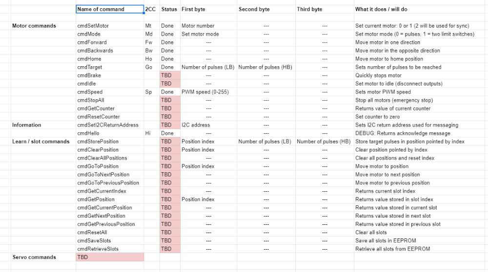

4. Standard I²C commands. Are there any standard commands for I²C I should use?
I'm creating my own codes to communicate between the motor module and the micro:bit (it's the "2CC" column at the spreadsheet above). I thought that there might be some standard codes around, I could use them if avialable. Won't make a difference in practice, since the I²C communication is already working (at least one-way).
So that's about it, at least for the motor module, and thanks again for your help. What I need now is simply to be able to control and sync the ft encoder motors. But I can't deny I'm ambitious, I think these ideas could be made into a community project some time in the future. Of course if someone in the community likes the idea and wants to replicate these modules and improve on them, or even create some more advanced modules, I'd be delighted. I have many ideas...

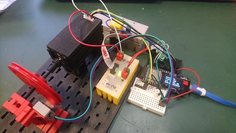

Here is my current test setup with a LOLIN32 OLED module, an I2C DC motor driver (Adafruit featherwing motor module) and a hall sensor for counting turns. As you can see, you were right about the printed housings :-) . My early results show that the pulse counter reliably counts all quad steps at all speeds. My next tests will be repositioning tasks to see if it keeps reliable when changing directions repeatedly.
Beautiful! Yes, I've been an admirer of your designs for ft for a long time in Thingiverse. Keeping track of pulse counts at this speed is really remarkable -- I'd even think that at 10 kHz some kind cable shielding would be necessary...

Beitrag von rubem » 29 Apr 2021, 01:47
Hi again,
The diagram below (not a schematic, it's just a drawing) shows an example of what I have in mind. This is an hypotetical model with one encoder motor, an S motor with two limit switches, an I²C ultrasonic module (not the ft one) and a small OLED display:
The ugly controller at the bottom has a micro:bit inside, but any controller with an I²C interface should work, hence the "ghost" TXT there. I wouldn't use a TXT, but the possibility is there.

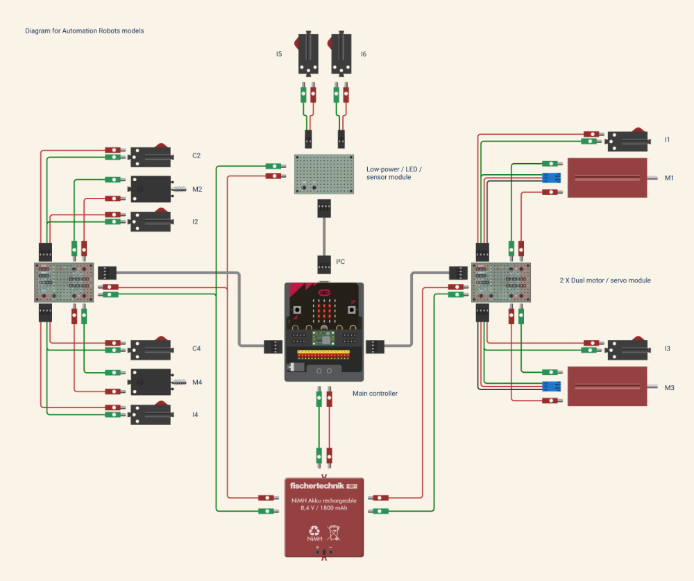

Here's an idea in the form of another pseudo-diagram, showing a way to use these DIY modules to replace the TX/TXT -- for existing models. This would be for the Automation Robots kits.
Automation robots.png (145.89 KiB) 287325 mal betrachtet

When you want to start with DRV8833, please also check its datasheet first to find out how to PWM the bridge the right way.
I'd rather ask Juh, he's already done it and he should know how it works. BTW, below are the DRV8833 modules. I also bought these two small step-down converters to get 5V out of 9V. They measure just 18 x 12 x 4.5 mm, they fit anywhere. The chip is called MP2307DN. Didn't test anything yet, though.

Here's an much better drawing of the "alternative Automated Robots" diagram. I also shows that even with all 4 motors and 8 push-buttons (the 4 models in the kit never use them all at the same time), there still would be room for additional hardware: four servos, 6 sensors and 8 LEDs. The LED/sensor module should support up to 8 inputs and 8 low-current outputs. Again, all this is still on the ideation phase, of course.
Automation robots 2.png (222.56 KiB) 287190 mal betrachtet
