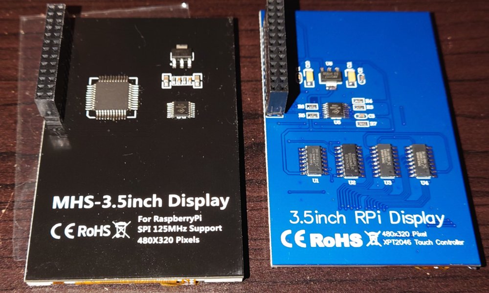

Hi Squid & Master.
Have made some progress and now have a new screen 3.5"
this is a "garsent" Raspberry Screen, 3.5 inch 480x320 TFT LCD Touch Screen HDMI Monitor for Raspberry Pi.
its meant to be waveshare but its actually looking more like an Elegoo https://www.elegoo.com/products/elegoo- ... lcd-screen
the good news its its not having the touch dropping out like the MHS high speed was
here are the 2 screens next to each other
the bad news is the touch axis is swapped v & h ....
i need to swap the following
Code: Alles auswählen
  “SwapAxes” “1” into “SwapAxes” “0"  in the config file
 /etc/X11/xorg.conf.d/99-calibration.conf
and then run the following commands
sudo dpkg -i -B xinput-calibrator_0.7.5-1_armhf.deb
DISPLAY=:0.0 xinput_calibrator
problem is i cant find the "LCD-show/" directory
reading the TX-Pi setup script i can see it copies that directory from the git
but if i try to find it, i cant see anything.
where is that directory in the txpi image

Hi Petabytemax,
Petabytemax hat geschrieben:
26 Dez 2020, 23:24
Maybe you can give the "Config" app a try: "System" -> "Config" and then use the "Hamburger button" to select "Display".
Use a different value for the "Rotation" value and restart the device.

Petabytemax
Beiträge: 18
Registriert: 06 Dez 2020, 22:34
Re: TX-Pi, Raspberry Pi Community Controller
Beitrag von Petabytemax » 27 Dez 2020, 00:33
tintenfisch hat geschrieben:
26 Dez 2020, 23:42
Anyway, I'd be more interested in your experience with the Config app. ;)
Best regards,
Lars
Hi squid, thanks for the reply
I tried the config and it worked to rotate the screen,
unfortunately my screen was displaying correctly ! so i'm now on my side,
( no problem easy fix to revert)
the issue I had is that the touch axis are wrong though USB mouse and KB work fine
it seems that although i tried TS calibration it doesn't fix it
i.e. if you move the touch position left the cursor on screen rises up
and vice versa ( drag finger up arrow goes left )
its like if you took off the resistive element and rotated ( or inverted it ) you would have the issue im seeing,
that's why I wanted to adjust the config. in "raspberry Pi OS" I have the same touch issue after the lcdshow install but I can fix it editing the config.
on a separate note, any idea what is the correct process to show pictures,
i'm using a link that works from my browser, and using the forum picture /img tags
but it doesn't show up
tintenfisch
Beiträge: 527
Registriert: 03 Jan 2018, 22:04
Beitrag von tintenfisch » 27 Dez 2020, 11:13
27 Dez 2020, 00:33
I see.
I've had the same problem with a display before. But I don't know how I solved it… :?
I think I tried a couple of values for "Rotation" (e.g. 180 instead of 0) and it worked.
27 Dez 2020, 00:33
I've no idea, but you can use "Dateianhänge" and upload an image and use the option "Im Beitrag anzeigen":

Benutzeravatar
MasterOfGizmo
Beiträge: 2727
Re: TX-Pi, Raspberry Pi Community-Controller
Beitrag von MasterOfGizmo » 27 Dez 2020, 11:28
You definitely have an odd set of Displays there. While I am sure the PCBs are the same as genuine Waveshare displays (they usually do 1:1 copies) the touch layer they use on top of the display may vary. What does the vendor say which driver to use?
Edit:
It's /usr/share/X11/xorg.conf.d/99-calibration.conf which has the option to swap the touch axes. Just change the paramter
Option  "SwapAxes"      "1"
From 1 to 0 or vice versa. This worked for me and broke the axes. So this should allow you to fix them.
Zuletzt geändert von MasterOfGizmo am 27 Dez 2020, 11:54, insgesamt 1-mal geändert.
Benutzeravatar
PHabermehl
Beiträge: 2565
Wohnort: Bad Hersfeld
Beitrag von PHabermehl » 27 Dez 2020, 11:52
Hi all together,
Sorry for my long lasting silence, but it's merely family time these days.
I experienced similar issues with several kinds of cloned displays. Sometimes I could fix it simply by calibrating the touch screen, sometimes I needed to install the dedicated drivers supplied by the vendor.
Actually that's the reason why I added the "NODISP" option to the install script.
If you go that way and use some no name clone, the best advice is to install your TX-Pi manually by using the script and NODISP option plus also installing the display drivers manually afterwards.
In the worst case you should not run the config app for display rotation and ts calibration because they may screw up the display config for those ubiquious displays and you even might have to re-install your TX-Pi.
Kind regards
Peter

Petabytemax
Beiträge: 18
Beitrag von Petabytemax » 28 Dez 2020, 22:38
27 Dez 2020, 11:25
27 Dez 2020, 00:33
Just in case you don't already know: TX-Pi provides access via VNC (enabled by default), you don't need physical access to your device.
Use the following URL http://IP-ADDRESS-OF-YOUR-TX-PI/remote/ and you can use your mouse / keyboard to operate on the device.
Hi Squid, thanks, I was aware of VNC and its very usefull as you suggest.
Petabytemax
Beiträge: 18
Beitrag von Petabytemax » 28 Dez 2020, 23:06
MasterOfGizmo hat geschrieben:
27 Dez 2020, 11:28
Edit:
Hi Master,
Appreciate you sharing the location, it got me closer but swapping the axis in the config file didn't work
this is strange as it did work in rasberry pi OS (hence the reason i wanted to find the config location )
I agree that these displays are a total pain, getting the right ones is hard as so many are unavailable or sold out, and ordering from ebay is a lucky dip what you actually get.
I now have two versions ( wish the MHS hi speed one worked ) and if there was more time i may go for the DSI compatible 5inch https://www.waveshare.com/5inch-dsi-lcd.htm as that works with the rpi DSI connector (so you can use all gpio), has a backlight control, a better capacitive touch and does not need a driver
As this is proving a such struggle the little boy got a toy drone for xmas instead of this Tx-Pi
this at least gives me a short extension as his birthday is 14th Jan and as he now has the drone I need to get this into a fit state to be his present !
So I rebuilt a fresh image with the recommended buster image and tried as peter suggested to install the tx-pi setup script with the NODISP option, this part seemed to work but there was no way to install the screen drivers afterwards
i tried it the other way round
fresh image
enable SSH
sudo raspi-config
apt get-update & apt-get upgrade
then installed the screen drivers
this part worked ok ( though i had to install git manually ) and their seemed to be some errors
I then
wget https://tx-pi.de/tx-pi-setup.sh
and ran the setup scrip with NODISP as peter suggested
sudo bash ./tx-pi-setup.sh NODISP
we are now close (hopefully)
1) the txt CFW came up after boot which was good
2) but the orientation was landscape not portrait
3) there was no display utility in the config app in system
4) so I edited the Config.txt in the boot directory to change the display from 90 to 180
dtoverlay=tft35a:rotate=180
5) the touch screen was still wrong ( x axis was ok , Y was inverted) off so I ran the TS-Sal App in the system folder
this fixes the issue and all seems ok
until i reboot and it then the axis is wrong again
Any ideas why its not accepting the TS-cal new configs ?
is it something in the NODISP option ?
whole screen was lands

Beitrag von tintenfisch » 29 Dez 2020, 10:20
28 Dez 2020, 23:06
fresh image
enable SSH
sudo raspi-config
I'd recommend to skip the
apt-get update & apt-get upgrade
step and run the
tx-pi-setup.sh
on a fresh Raspian installation since the script pins some packages and does the update / upgrade step anyway.
28 Dez 2020, 23:06
Which driver do you use?
28 Dez 2020, 23:06
The TS-Cal app just modifies the option "Calibration" in
and does not change any value regarding the axes.
Regarding the inverted y-axis:
Try to modify the
Section "InputClass"
    Option  "InvertY"   "1"
Either add the Option
or change the value from "1" to "0" or vice versa.
Best regards,
Lars

Petabytemax
Beiträge: 18
Beitrag von Petabytemax » 08 Jan 2021, 11:17
Happy new year to all at the FTC community !
thankfully and with help from many here ( as well as a little detective work ) I finally have the Tx-Pi working with a responsive touch screen.
this is great news and will be a fantastic birthday present for our young son next weekend.
as this screen ( Garsent brand, but seems identical to https://www.elegoo.com/products/elegoo- ... lcd-screen )
seems to use the "goodTFT" driver i had to do a manual Tx-Pi scripted install and then
git clone https://github.com/goodtft/LCD-show.git
chmod -R 755 LCD-show
cd LCD-show/
sudo ./LCD35-show
this worked but the axis were wrong, however using the options shared by "TinTenFisch"
