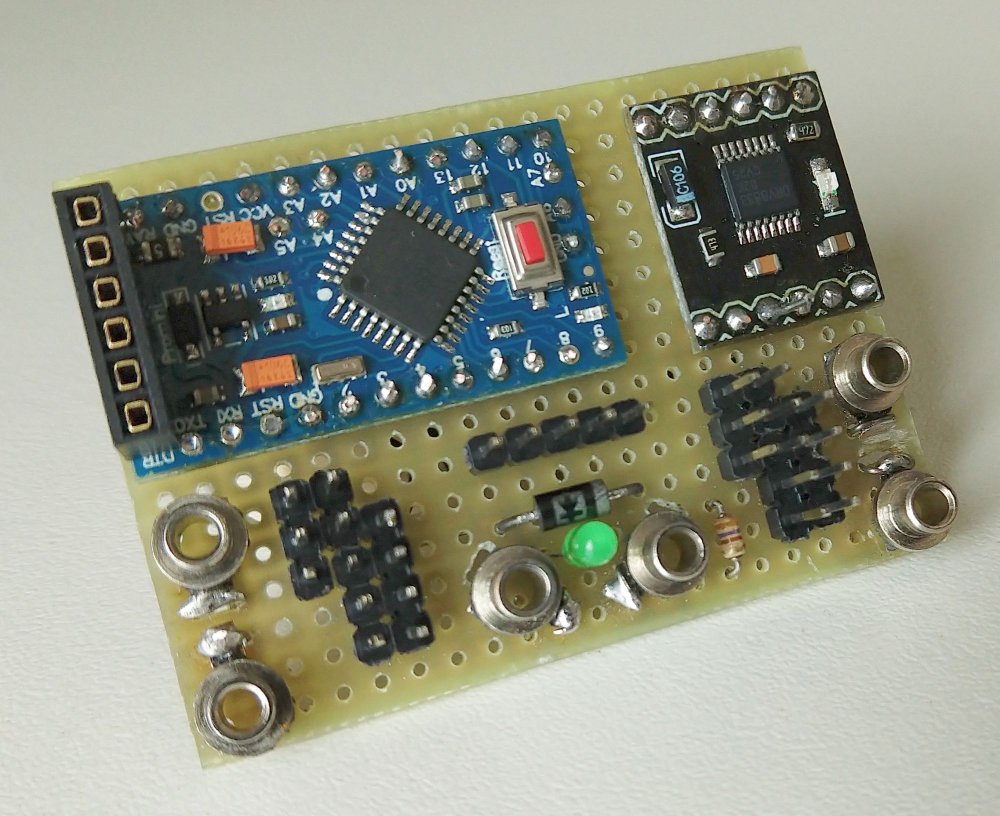

Here's my second version of the motor driver prototype on a perfboard. I gave up on the first version, I was planning a 45 x 30 form factor with a "sandwich" layout where the Arduino and the driver would go under the connector board. But it wouldn't work, the assembly was too complicated and error-prone. With 60 x 45 I have more room and soldering is kept simple.
It's still under construction, I've just wired the power lines... and then realized my layout is potentially destructive: The Arduino has many contact points, and an energized 9V ft plug would fry it at once. At least before I build a housing (and protect the outputs), I'll certainly remove the two 2.5 mm jacks near the LEDs and use only the pin headers to power the unit. Better safe then sorry. I'm not worried about fischertechnik compatibility, and it seems I'm in good company.

@rubem, your new PCB looks very neat! And I understand only too well why you went for a non sandwiched design. I used one in the (unpublished) Adafruit V2 motor controller shown above, and also here, and things tend to become very complex and tangled up soon with these designs.

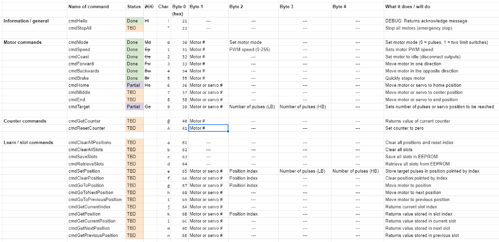

Nevertheless it seems we have somewhat similar goals with our projects, but yours is obviously more ambitious in terms of scope and precision. For example, I've been testing the break function with the ft encoder motors. MoG was right! For the same speed, the motors always stop at the same position, generally only 2-3 extra pulses. The consequence is that I don't need fine speed control or PID, at least for now.
I have been looking at the state diagram you provided and it makes a lot of sense. I'm thinking if there is something I could incorporate in my commands, I'm still working on them. At least you inspired me to update my table which was already obsolete. I know it's hard to read, but not impossible:

I've converted the table from Google to to .ods. The file is in the repo now:
https://github.com/leosdad/fischertechn ... /main/docs
And here is the direct link to it (OneDrive account required):
https://1drv.ms/x/s!AoEOnU-XO9iY1ssr99u ... Q?e=oYoeLL

Rubem, your table is interesting to see (BTW: you can link github downloads directly). Do I understand your idea about the Learn/slot commands correctly? Do you want your controller to run a list of movements independently from memory? I haven't thought about that yet, but of course it would be a nice feature e.g. for exhibition models.

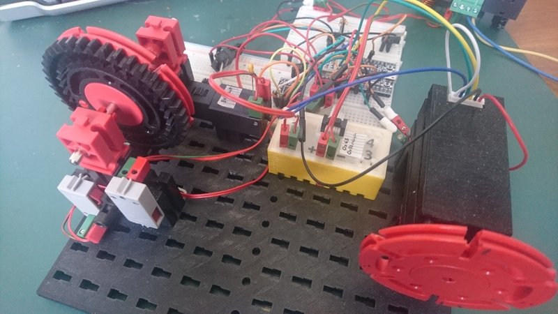

In my project I did some testing of the subunits developed so far. This setup shows a working QPID system with two seperately controlled QPID units:
On the right is the geared motor with hall sensor and ESP32 hardware encoder that you already know. On the left is a fischertechnik XS motor and a quadrature encoder with ft switches and "Impulszahnrad". It is driven by an Adafruit MotorshieldV2 via I2C, the encoder could be evaluated with another EPS32 hardware encoder, but for testing it uses a polled quadrature encoder library which could also work on a plain Arduino. Everything works within the QPID framework, which shows that the subunits are in fact completely interchangeable, so for example you could easily update the motor driver to a more powerful one by just adding a new derived MotorDriver class to the system.
PID, in fact, would be overkill for a slow and clumsy unit like the ft one. So I'll probably add motion ramps as an alternative to the PIDs at a later stage. However, PIDs even here could be useful if not positioning, but running at a constant speed is what you need.
The idea here is to store up to eight positions per encoder motor. I want the motor driver to keep track of the current position for each motor so that the main controller (e.g. micro:bit) will be able to use only high-level commands like GoToNextPosition or GoToPosition, for example. I admit there is currently some confusion between the terms slot, position and index, but I'll eventually address this. The main controller is still responsible for consuming events and issuing commands to the motor driver.
