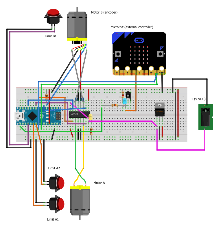

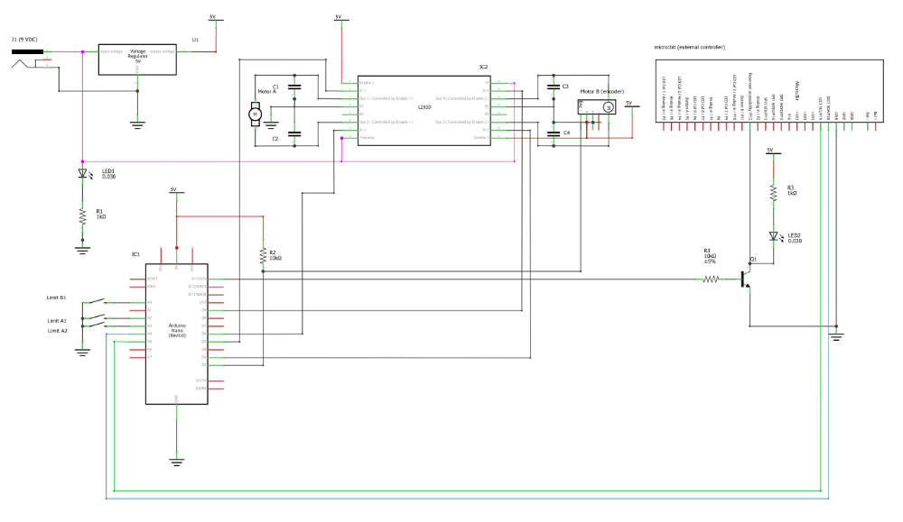

Hi everyone,
I've just uploaded a Fritzing file with the current version of my test setup (i.e. still with the L293D):
And the schematic:
I found some discrepancies with the names I gave to the pin numbers, sao I've corrected them in the Fritzing file. I still have to go back to the code and check them again.
The URL is: https://github.com/leosdad/fischertechnik-modules

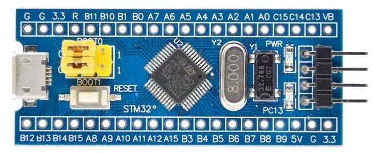

To @Juh: I just received an email advertising the board below, looks interesting. It's an Stm32f103c8t6 Arm Stm32, Arduino IDE-compatible and readily available at a very low price. It's a bit on the large side at 53 x 22 mm, but has some intersting specs for the price. It says it runs at 72 MHz but it has a very conspicuous 8 MHz crystal.
The email links to this article in case you want to exercise your Portuguese skills :D
A quick note: The first tests with the DRV8833 board were encouraging. Fast brake, good torque at low speeds... Until it stopped functioning. All of a sudden nothing moves anymore. I'm not sure if it's the nSleep pin (but I didn't really change anything) or the board was fried, I'll check it out this weekend...

Yes, rubem, and most importantly these boards also have hardware quadrature encoders. IIRC there are even versions which are pin compatible to Arduino Nanos.
It's hard to keep an overview over all the possibilities, hard- and softwarewise. But our ressources are limited, so I often stick to what I know, well knowing that there might be better options out there. I plan on using WiFi and maybe BT as an alternative control mode in addition or as an alternative to I2C, that's why I'll stick to the ESP32 for the moment, but the Stm32 might be a very good alternative if it's I2C only what you want.

This is really not nice to 'hear'. Could you eventually consider to give some schematic of your DRV8833 setup, please?
And maybe this time you could give some higher resolution? Your L293D setup I just can barely read and it was the Fritzing sketch to give some better insight.

The Fritzing files are available in my GitHub project:
https://github.com/leosdad/fischertechn ... n/fritzing
Coincidentally, I've pushed the DRV8833 schematics yesterday. Here are the images, GitHub shows them very nicely:
https://github.com/leosdad/fischertechn ... ain/images
I agree, the schematics above are unreadable. <off-topic>I suspect the forum shrinks files above a certain size. For some unknown reason it does not accept WEBPs (way smaller than PNGs) or SVGs (vector format). (Sorry, pressed Submit instead of Preview again...)</off-topic>

Hi again,
Some quick notes about the 8833 diagram:
  • I suspect I'll have to swap D9 and D11 so that D11 connects to the DRV8833's IN1. Reason is that D9 and D10 seem to work together for servos. I didn't test the servos yet.
  • I still plan to add some protection diodes and/or resistors to the inputs.
