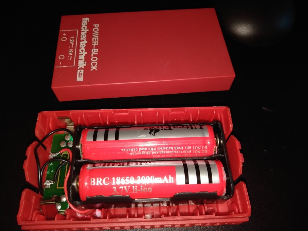

Re: Frage zu "ft-Roboter mit Arduino": Stromversorgung ?
Hello Esther,
I have converted a FT battery case to a 2x 18650 Li ion battery case. It fits, it gives 7,4 V in total, enough power to last a few hours. They are cheap and can be recharged.The block (an old 6x AA FT case) also fits nicely in smaller robots.
Dear Floris,
thank you for your input.
Which controller do you run with this power supply?
In the image, some additional electronics is visible. Could you perhaps give some more information on that?
Thanks!
Cheers
Esther
Thanks!
Cheers
Esther
