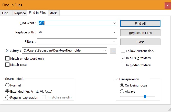

Hello PHabermehl, thank you so much for response!
I was reading about conversion dos2unix in windows and tried different methods. Then I finally found one using Notepad++ to make the conversion and my problem was solved. It's important to know that you need to convert Python and Manifest files(you select the folder with all your files) to make it work.
Thank you for help and hope this post can help other people with same problem in windows.
Dateianhänge
This what you need to do in Notepad++, go Search -> Find in file and then do this:
