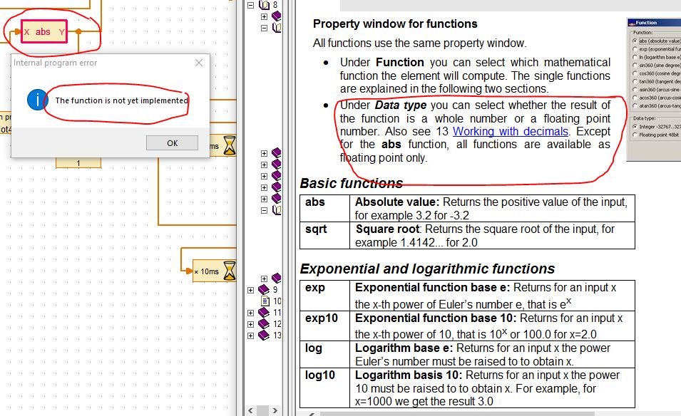

Base on the help, the ABS function is for both int and float.
However in RoboPro 4.6.6 (fw 4.6.6 and 4.7.0) the ABS is giving an error.
Is this a bug?
overview message.
overview message.

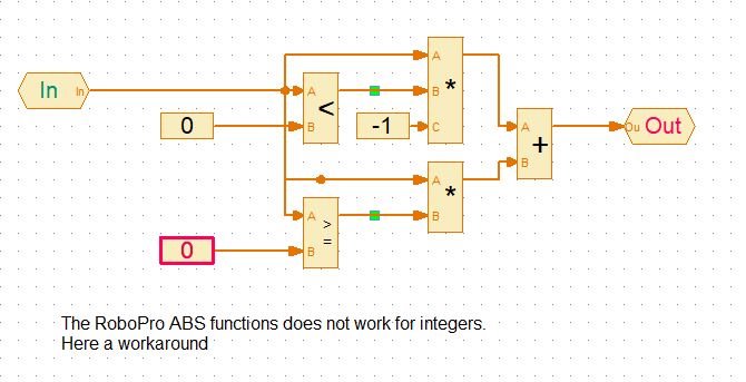

Temporally workaround for this problem/bug.\:
workaround
workaround
