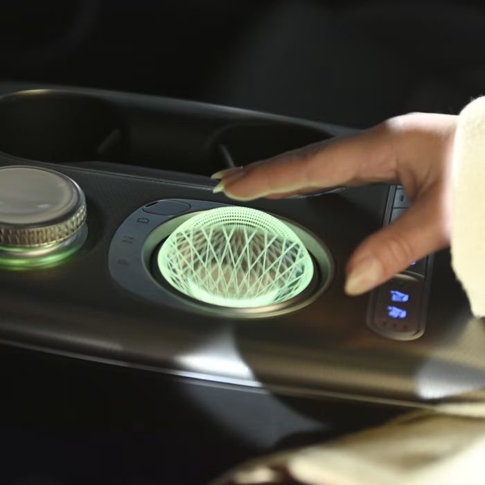

...and now there's this gear shifter:
As shown here. Unfortunately I don't have access to the whole story, but it's kinda obvious.
:shock:
Rubem
