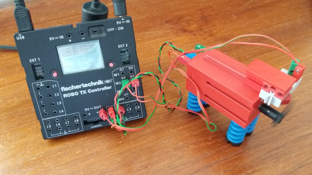

Fischertechnik TXT Smart Home set with 2 encoder motors.
Today I wanted to use my new encoder motor from the Smart Home set. I'm sorry, but it wouldn't run. As an old technician you're going to see what's going on inside. To my big surprise I saw that the connection pins of the motor as well as the shielded wire were never soldered. Normally you would have to send that back but to keep it simple I will solder them myself.
After soldering these 3 points, the motor runs perfectly again.
Soon I'm going to measure the encoder. Then I will be able to display the correct number of pulses per revolution and the gear reduction ratio.

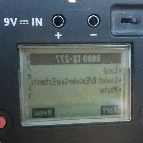

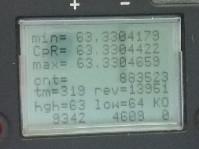

The encoder test.
The purpose of this test is to measure how many pulses/revolutions the encoder gives out. It also measures the correct gear reduction ratio. To measure this correctly, I placed an encoder disc on the output shaft. Connected to it is a quadrature decoder. The disc has 25 magnets so the number of pulses per revolution is 100.
The FT encoder is connected to the first hardware 20 bit counter. The second 20 bit hardware counter is connected to the quadrature encoder. This counters are located in an FPGA module that works via an I2C connection to the TXT-Controller. Via the Robopro software the motor parameters can be passed on. The motor itself is fully controlled by the FPGA. A Soll value of 1000000 is given by the TXT and the motor will run until this number is reached. Both 20 bit counters are displayed by the TXT.
The number of quadrature pulses of 1000000 corresponds exactly to 10000 revolutions of the motor shaft. By now also reading the number of pulses from the 20 bit hardware counter of the motor encoder itself, we know how many pulses per revolution the FT motor gives. Immediately we also know what the gear reduction should be.
The photo makes the results clear:
Hd picture on Flickr: https://www.flickr.com/photos/fotoopa_hs/50016668946
The number of pulses per revolution is therefore not 64 as some documents indicate, but 63,8880 which gives a gear reduction of 21,296 (not 21.3). The motor runs approximately 180 rpm in this setup ( no load ).

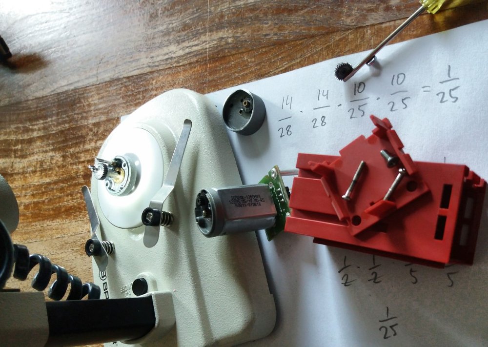

Hello Frans,
Yes I know, this sight is hard to bear, but the patient survived (-;
My little surgery - I counted twice - resulted an exact 1/25 ratio, at least with one of mine old type encoders.
Best Regards,
Helmut

hamlet hat geschrieben: ↑
19 Jun 2020, 18:06
Hello Frans,
Helmut
I have no reason to doubt your count.
I adjusted my measuring setup to connect the FT encoder on 9V. My previous measurements were on 5V. Again I measure no difference. I also added an extra digital filter to the FPGA so the signals should have a minimu high and low time. All without result, my measurements remain. I can't explain it for the moment, I would have preferred the value of 25 because it sounds so logical.
This will give me a sleepless night, and tomorrow I don't see a solution, because then we will be married exactly 50 years. We'll have a little party with the kids and grandchildren.

… So also I did some measurements but with a rather simple setup:
20200627_125851 (Groß).jpg (123.03 KiB) 30036 mal betrachtet
Both, the encoder and the revolution counter switch, are connected to the TX fast digital inputs that are sampled with 1kHz. The program waits for a rising edge of the revolution switch, reads out the encoder tics, calculates the encoder tics increment with respect to the last revolution and sums up these increments to the total encoder count in a RoboPro float. Here the "unsigned integer to float" cast function is used as it can cope with the revolving 16bit signed integer encoder values. With their 32bit mantissa the RoboPro floats are exact for integers up to ~4e9. From the total encoder count and the revolution counter the mean Counts Per Revolution (CpR) is calculated. The encoder increments per revolution are monitored. Each time a rising edge, e.g. 63->64 is detected, the program estimates the lower and upper bound of the CpR value. The CpR result from the 64 count revolution is taken as the upper bound and the CPR result from the 63 count revolution just before edge is taken as lower bound.
The program provides valid results only on the TX in offline mode, because in this setup the RoboPro thread is called with a rate of 1kHz. On the TXT this rate is a non-exact 100Hz and in offline mode it's even worse. Then the revolution switch trigger for the encoder readout jitters too much and the measured encoder increments per revolution fluctuate.
The program is available here: https://1drv.ms/u/s!AjSvbnB4EKxJmSR7Om9 ... 1?e=Y84wRi
The resulting Counts per revolution for my new type encoder is somewhere in between 63.33041 < CpR < 63.33047
maybe it's
Code: Alles auswählen
30   25   23   28
-- * -- * -- * -- = 21.11014 => counts=63.33042
10   13   16   11
20200627_143808 (Klein).jpg (47.02 KiB) 30036 mal betrachtet
The display:
min: lower CpR bound
CpR: Mean value for counts per revolution CpR=cnt/rev
max: upper bound
cnt: total encoder counts
rev: number of revolutions
tm: time per revolution measurement in ms
hgh: expected upper limit for encoder increments and total count of revolutions with this value
low: expected upper limit for encoder increments and total count of revolutions with this value
(… low and hgh are swapped in the picture)
