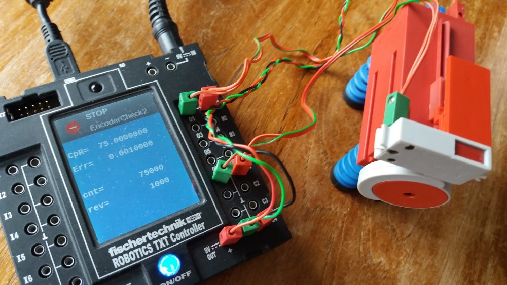

My aim was to get a better knowledge of the gear ratio of the new type encoder that I own. Some time ago we already found out that it is not the documented 63 counts per revolution (CpR) but rather something near to 63.3 CpR. I wanted to know if it might be a 63+1/3 CpR, which would have been nice, because then one could expect an integer number of 190 counts after three full revolutions. OK, this is not exactly the case (~63.330) but at least a good approximation for a lot of applications.
Also my aim was to realize this with a minimal effort setup using ft parts only, so that everyone can repeat this measurement to identify the encoder gear type, that ft has changed w/o notice for both encoder motors, old (75 vs. ~76.172) and new (~63.330 vs. ~63.888). Maybe there are even more different types around?
Yes, this setup isn't perfect, but I think the results proof that it's absolutely sufficient for a quick measurement.
I've simplified the program! Now it works reliably even on the TXT with the "high speed" old encoder motor type.
20200628_170858 (Groß).jpg (144.86 KiB) 4885 mal betrachtet
Thanks to Frans for the "flying stop" hint! With creeping speed at start and stop the results look fine.
You have to make sure that the revolution counter switch is pressed sufficiently long, e.g. half of the revolution. Otherwise the TXT might miss some revolutions counts. As Carel correctly stated the high/low times have to be longer than 10ms, … better more.
The program is available here: https://1drv.ms/u/s!AjSvbnB4EKxJmTw-2IY ... F?e=SZxdNa
If anyone is interested in the program, please give a short notice. I will add some documentation, do some further testing and upload it to the ftc download area.
Have fun,
Helmut

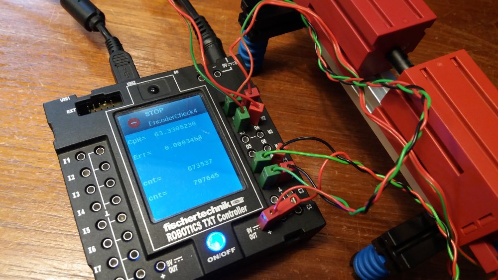

Being frustrated, I had an idea. ft has provided a very reliable and easy to use reference counter, the old exact 75 CpR encoder motor.
Here is the result:
20200629_195119 (Groß).jpg (152.46 KiB) 4758 mal betrachtet
Simple and stiff HW. And simple and robust SW, as the counter values are reliably determined in real time on the TXT's Cortex M3
core. So there's no need to care about the lags and jitters of the RoboPro Linux process on the cortex A8.
I hope that I did the error propagation correctly. I was rather pessimistic and assumed 2 tics of error, one for the start and one for the actual measurement, for each of the encoder. I added the errors of both encoders linearly, i.e. worst case.
The program is available here: https://1drv.ms/u/s!AjSvbnB4EKxJmT-GaEB ... s?e=CcystI
And also with this setup the new type encoder motor's CpR is 63.330x not the nice 63+1/3 we hoped for.
This result is absolutely compatible with your results: With those ugly odd gear ratios you have either 63 or 64 counts in each revolution and your calculated mean CpR is either a bit too small or a bit too large depending of the last revolution's count, and almost never on point, even if you count correctly. Thanks to H.A.R.R.Y. for this hint! In the test you presented in the ftpedia you did 300 revolutions and thus the error is about 1/300=0.0033. So your and my results are absolutely compatible.
I also believe that Frans has owned one of those "bad" encoders that were equipped with a different gearbox. He measured the 63.888 CpR.
Have fun,
Helmut

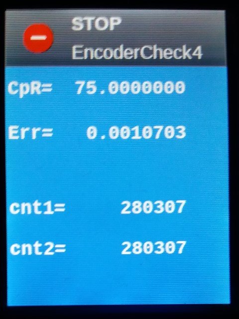

Hey H.A.R.R.Y.
Good point!
Two old type encoders:
20200629_212757 (Klein).jpg (64.04 KiB) 4738 mal betrachtet
At some of the periodic updates cnt1 and cnt2 differ by one or two tics, but usually in the following update the two counters match again, sporadic small glichtes, nothing that piles up.
I would say, "Test Passed!"
... and now back to "DCI Barnaby" (-;
Best Regards,
Helmut

Hello hamlet,
thank you for this last doublecheck. I fully agree. 1 tic of uncertainty per counter and by chance one is 1 tic ahead while the other just is 1 tic behind. A mismatch of just 1 is more common and a mismatch of 0 is perfect. As expected.
:thup:

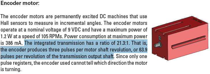

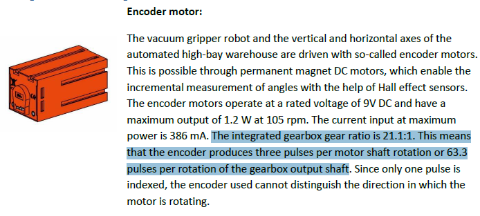

Also in the official ft documentation the new type 153422 encoder motor is specified "same same, but different":
https://www.fischertechnik.de/-/media/f ... 9v_en.ashx (Feb. 2018)
Anmerkung 2020-07-07 125658.png (68.38 KiB) 4508 mal betrachtet
https://www.fischertechnik.de/-/media/f ... h_neu.ashx (Sep. 2019)
Anmerkung 2020-07-07 130816.png (60.11 KiB) 4508 mal betrachtet
Kind Regards,
Helmut

Thanks for both pictures with the data of the FT motors.
I understand they mention 21.3 ratio. The error is small so this rounding will give little problems with normal use. I'm staying with my results of the measurements. The max measurement error I can have is +- 1 pulse on a total of 1000000 pulses from the FT encoder. This is because the reference pulses are on the output of the mounted disc. The FT pulses always flotation with respect to my reference. You can also see this when you read out the encoder signals with the scope during the measurements. The reference trigger stands still, the FT pulse shifts. It is always nice to be able to measure correct values and also explain them by the gear reduction ratios.
The 21.1 ratio is totally different with the motor that I bought recently. Sometimes it is still difficult to find correct data!
Frans.
