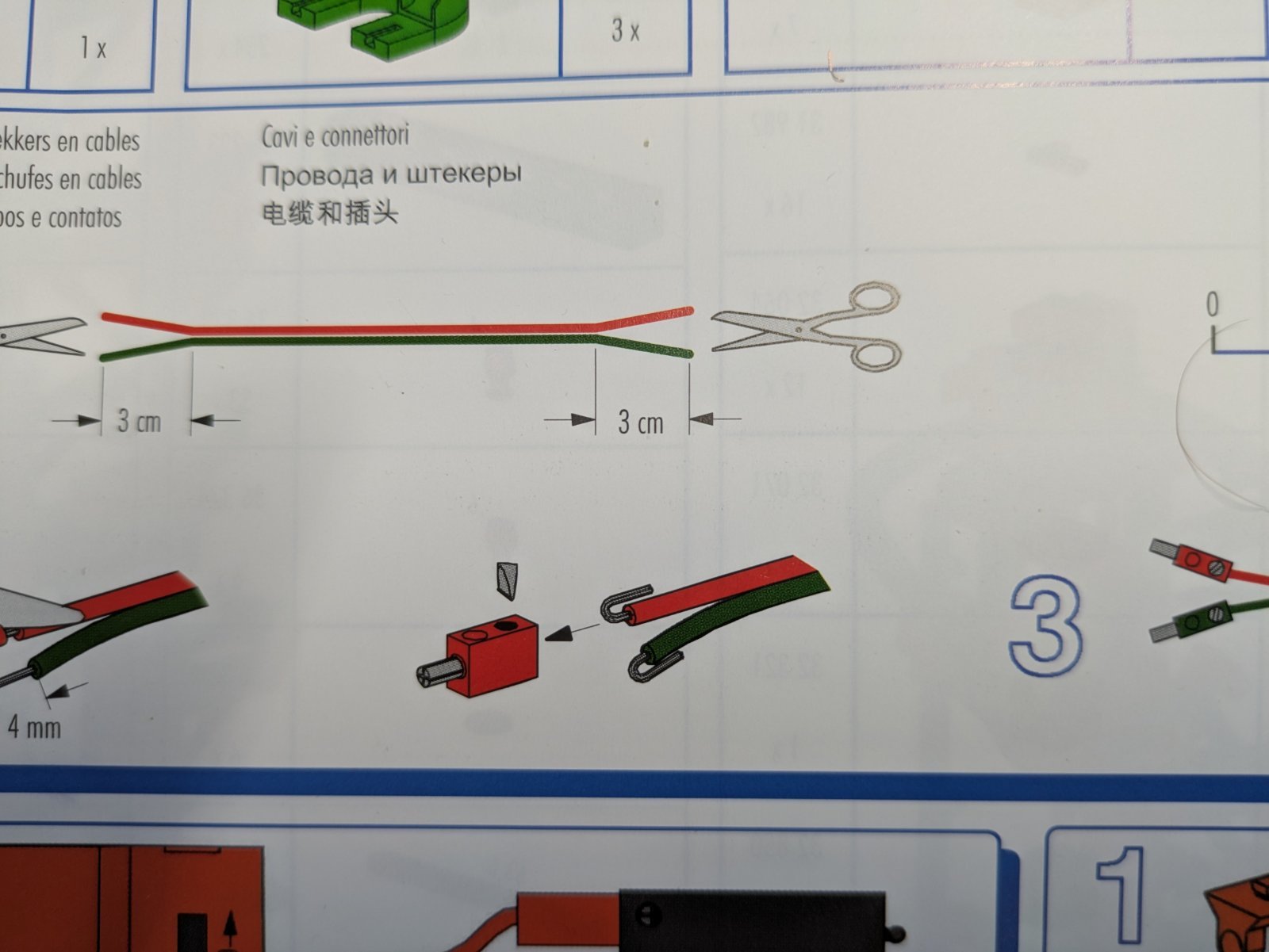

we are building with my son the marble run - Dynamic L2. Everything is ready, but we are struggeling with the Kabel montage for motor. The manual is not clear for us. Could you tell us please what to do?
When we put the cable more inside, the clip does not go anymore to clap back. Or the cable is cut by the clip.
We dont understand the picture.
Pls help.
thanks,
Marian

Re: motor XS Kabel montage
Marian,
English:
These new Fischertechnik connectors are truly awful to work with. I still don't understand how they came up with that.
It looks like you followed the correct procedure, but the cable needs to be pushed a little further into the cover, as far as it will go. The cable shouldn't be stripped. Insert the cable into the connector's eyelets as far as possible. Place the connector (with the aluminum part facing down (where there's a hole)) on a flat surface and press the cover shut. Be careful not to pull the cable out a bit.
The aluminum should cut through the insulator and make contact with the copper wire.
Your picture is of the old screw-type connectors. They were/are much better.

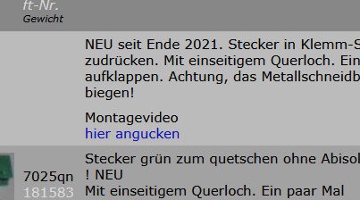

Hallo,
so langsam treiben Zugänge zu Links von Firmen seltsame Blüten.
Je mehr KI und Bots im Internet umso schlimmer wird es werden.
Kam gestern über den Link "Montagevideo" von Fischerfriendsman an den Videoclop
von Fischertechnik selbst, wie geschrieben mit einem kurzen Werbespot.
Heute morgen mal direkt über den von mir eingestellten Link hier im Thread. Jetzt soll
ich mich erst anmelden weil die Befürchtung besteht, ich wäre ein "Bot". Klappte auch nach
etwas Warten nicht, warum auch immer.
Dann versuchsweise nochmal über über den Link auf der Webseite von Fischerfriendsman.
Klappte nach kurzem Warten und über den kurzen Werbespot..., ohne Anmeldung.
thanks a lot!!
We will try it tomorrow and hopefully it will work.
I will let you know.
Thanks again.
We have done based on your advices and it works!
