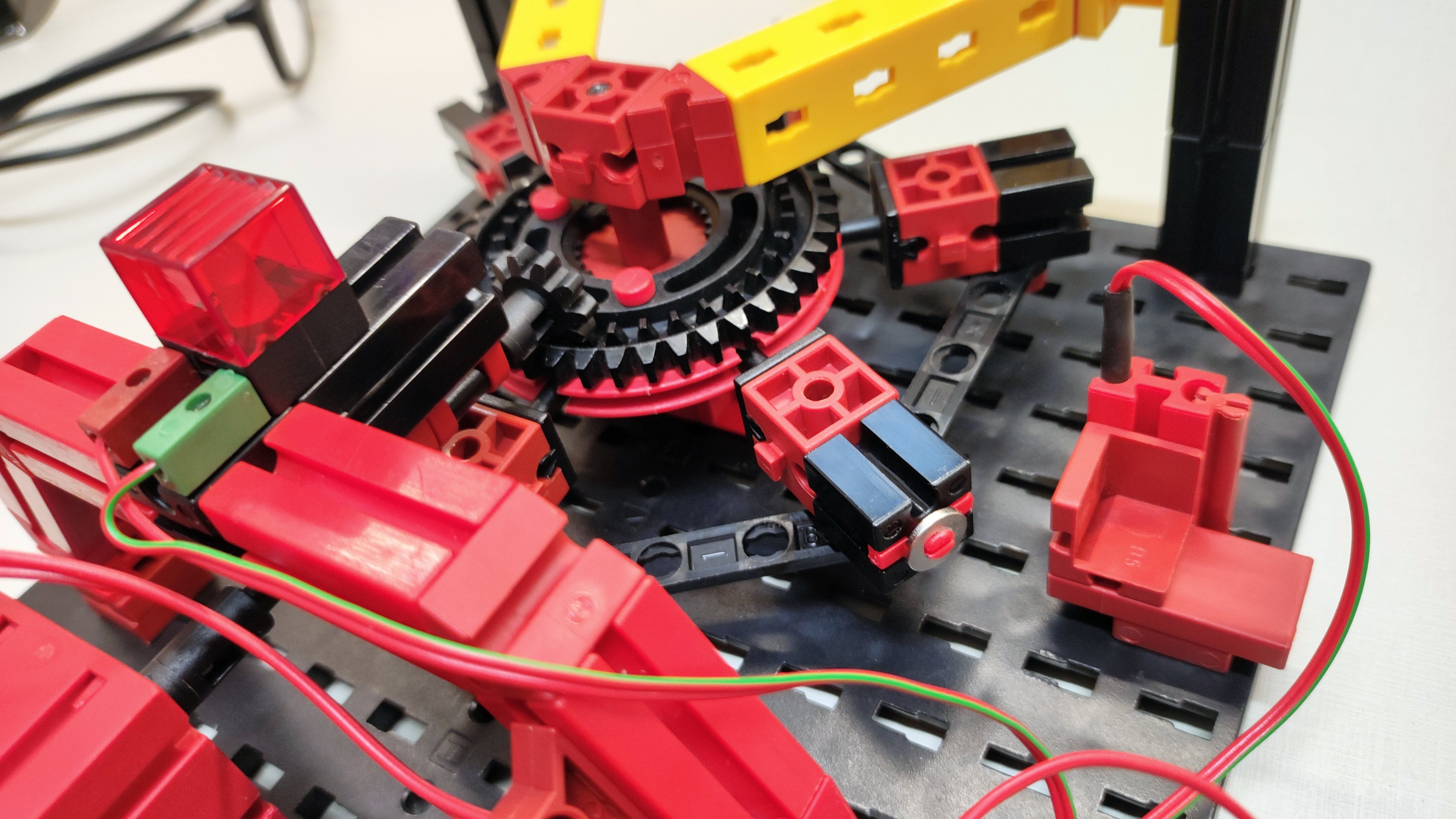

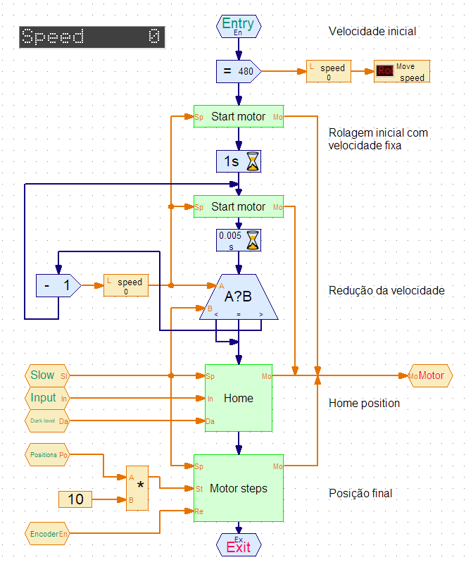

My two POCs are shown below. The mechanics of both models are identical: An encoder motor with a Z10 pinion that drives a Z40 (32 teeth at 90°) which rotates a turntable with 6 spokes. One of them has a yellow plate acting as a marker for a luminosity sensor.
1) The right POC uses a TXT and ROBO Pro. Here is the rpp file. The motor starts at full speed (512), keeps it for a while, then decreases its speed to 150. Then it waits until the luminosity goes below a certain threshold, meaning the yellow plate is below the sensor. Finally it counts some encoder steps, then stops. The pushbutton is used to restart the test. The goal is to stop at precisely the same point each time. My observations:
  • The stop point is very consistent provided the motor and the slow speed value is kept the same.
  • However, the stop point will vary quite a bit when the slow speed is changed to, say, 200. Increasing the final speed moves the stop point ahead and vice-versa. I thought the encoder would be very precise... But the flaw may be in my program, I have very little experience with ROBO Pro.
  • Different 135484 motors have noticeable different slow speeds and stop points.
2) The left POC is Arduino-based with a DRV8833 motor driver. The code is quite straightforward, using a finite state machine arranged to perform the functions similar to the ROBO Pro program. An external interrupt counts the pulses sent by the encoder. But the result are different:
  • The precision is lower. The stop point is less consistent and may vary quite a bit. Maybe there is something wrong with my code when reading the encoder pulses? I expected at least similar results to those with the TXT.
  • The stop point variation according to the final (slow) speed is even more pronounced than with the TXT.
  • One difference in this circuit: Both the encoder and luminosity sensor are powered by 5V, not 9V since I don't want to overload the Arduino inputs. (With no oscilloscope I can't measure the actual output levels, so I'd better play safe. Maybe I'll use a resistor divider in the future.)
  • The max speed (255) is noticeable faster than with the TXT.
Any tips?
Warmest regards,
Rubem

Beiträge: 1155
Re: Best hardware approach for complex project? / Bester Hardware-Ansatz für komplexe Projekte?
Beitrag von juh » 19 Mär 2023, 21:13
If anything, you are succeeding in raising couriosity for your upcoming project. ;-)
rubem hat geschrieben:
19 Mär 2023, 19:02
However, the stop point will vary quite a bit when the slow speed is changed to, say, 200. Increasing the final speed moves the stop point ahead and vice-versa. I thought the encoder would be very precise... [/list]
Is it really the encoder's problem, here, or just the behavior to be expected? Isn't it normal that the motor will not come to an immediate halt after having reached your given number of encoder steps, even if you put the driver in brake mode? And if it's faster it will take longer to brake. I think this is exactly the problem with speed ramps that we talked about in an earlier conversation. I had exactly the same problem in my latest quad encoder video where the precision you can see is kind of fake, as I adapted speed to distance so that the motor would come to a stop where it should. Independence from such variables is exactly what PID is about, isn't it?
I can't speak to the TXT stuff and running ft hardware at 5V.
Otherwise, I had a look at the Arduino side and couldn't see any obvious reasons, only that you did not declare the variables which are changed in the interrupt as volatile. I think in theory that could lead to counting problems. Apart from this, my approach would be to simplify for testing. The state machine seems to be mostly linear, so personally I'd try to do without it for testing. Also, interrupts are fine, but they add an extra level of complexity. For counting encoders, it is ok to poll them, as long as you are sure the polling takes place at least every n/2 seconds, with n being the minimum delay between two signal changes. So at least for debugging, I'd try to do without them at first, and handle the two states in the main loop.
Just my 2 cents. ;-)

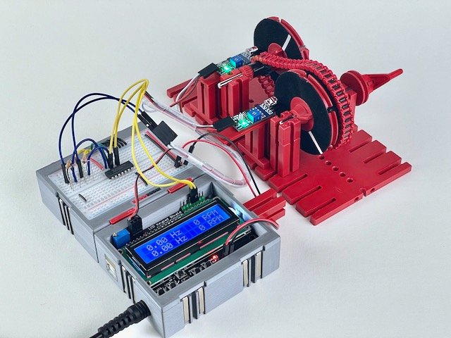

I tested the encoders of the fischertechnik encoder motors and checked with an oscilloscope: they work perfectly with 5V supply voltage and have an open collector output. Therefore - if not done already - activate the pullups in your arduino controller for these inputs.
Kind regards, uffi

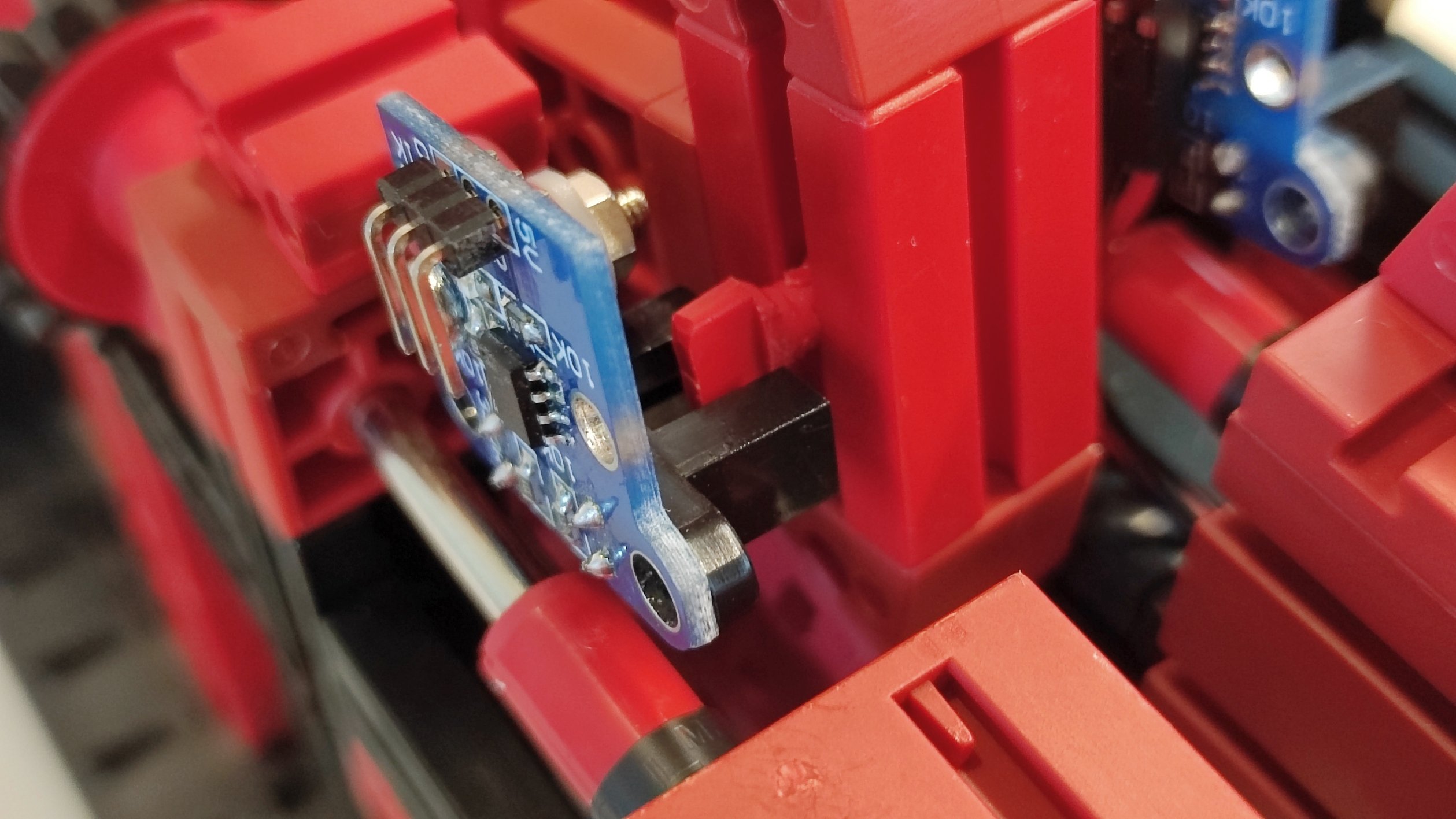

I've made an important change in my setup so that a magnet and reed switch have replaced the color sensor as you can see below. I also made several ajustments to the Arduino program (special thanks to Juh :D who kindly sent me his ideas and code) and the combined result is that precision is much higher now. The updated code is here for those who are interested.
magnet & reed.jpg (1.1 MiB) 16273 mal betrachtet
As for the details, I pressed a 10 mm ring magnet on a S-strut adapter 31848. This assembly is a lot smaller and easier to attach than the magnetic ball holder 119850 which works equally well. The sensor is a small, cheap plastic reed switch inserted into a ft slot. Curiously, for some reason the internal pull-up in the Arduino pin was not enough so I had to complement it with a pull-up 1kΩ resistor. Odd!
This was (I hope) the most difficult part, I think I can move on with my project now. Being unable to use a TXT / TX (again) is a bit of a disappointment... :(
Best regards and thanks to all,

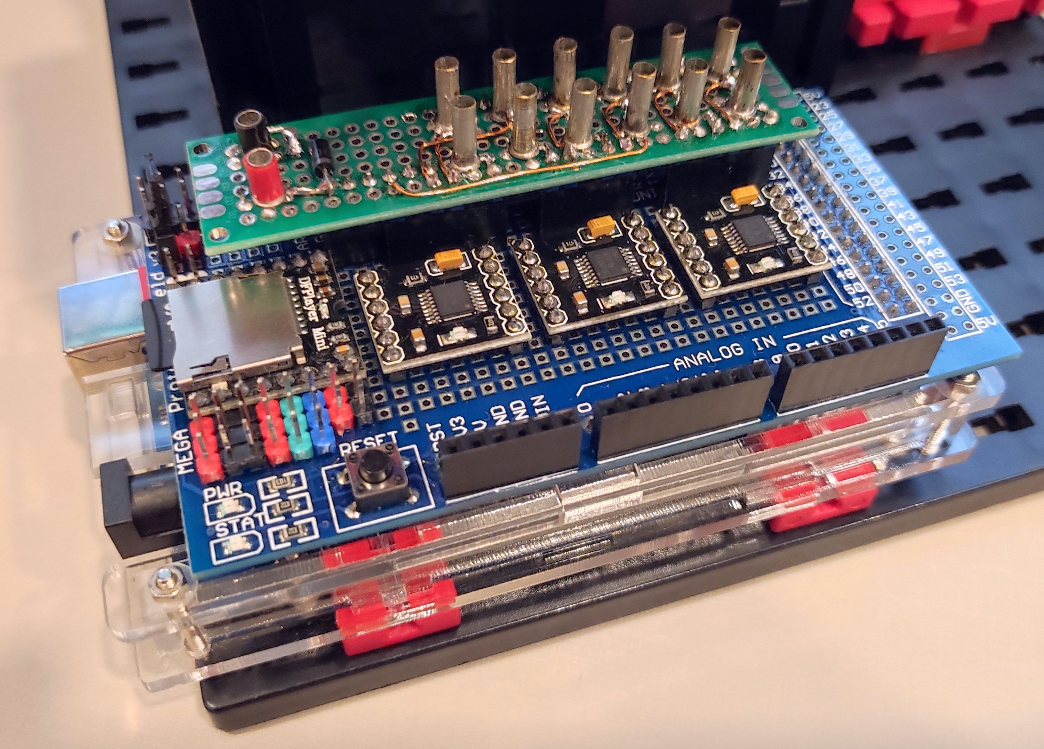

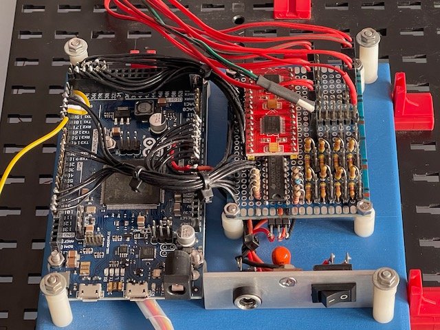

Inspired by Karl's thread I purchased some HC-020K encoders (see my post here) and they were the best option, so precision is finally good.
Regarding the controller... Florian (atzensepp) hinted me to go for an Arduino Mega instead of expanders. I finally decided to give the idea a try, so I bought one plus a transparent case and prototype shield, and the result is this:
The prototype shield received a Mini MP3 player plus 3 dual motor drivers, so this controller has sound and can fully control up to 6 motors with PWM. The "mini-shield" on top of it has a 9V input and ft sockets to facilitate the connections to the motors.

Hi Rubem and others,
(Entschuldigung für das Englisch, ich denke, die meisten Leute hier können das ohne Übersetzung lesen?)
This seems to be the main thread (did an answer to the sub-thread at viewtopic.php?f=8&t=8018 ) I would not post too much stuff twice, but perhaps some additional feedback (or just my 2cts, for what it's worth).
I understand that you plan to make a PWM-driven motor controller with DRV8833 modules? For as far as I have learned (the hard way, and it took a long time to figure this out because the visual differences between my DRV8833 and TB6612FNG boards where actually almost NONE) this is not possible with the DRV8833. Please consult the datasheet, you might consider a TB6612FNG instead.
[EDIT: not exactly true, the DRV8833 can be used with PWM. Difference is it needs 2 inputs per motor, where the TB6612FNG uses only one]
Furthermore, 16 MHz is not that much to meet your I/O specs. I have experimented with both PCF8575 and MCP23017 over I2C and with counters on interrupts and a display active you might easy miss input polls in your main loop. Consider taking a modulair approach with various state machines driven over I2C and e.g. an ESP32 or Raspberry for your main controller.
It's not quite clear to me what you're trying to do (hey, it's a secret project ;) ), but apparently you want to measure rpm with the ft luminosity sensor?
You might find my recent experiments on https://www.whizzbizz.com/en/rpm.meter useful, in which I measure reflections with dirt cheap IR obstacle sensors. Proof of concept done with an Uno with LCD shield and an additional Schmitt trigger.
Well, no, not really, I don't need to measure RPM. The luminosity sensors were merely used to find a "home" position on the wheels. But I needed better precision than the sensors and a 15 x 15 yellow plate offered. I tried a reed sensor and ring magnet which, along with code improvements (no interrupts needed, thanks to juh) worked together and increased the precision (see photo above). A further improvement was possible using fork sensors HC-020K after reading Karl's post. There are several mounting options for it.
Here is the current setup. The home position is found when the S-Rivet 4 crosses the fork sensor:
Fork sensor with S-rivet.jpg (348.45 KiB) 15721 mal betrachtet
Thanks for your ideas and for pointing me to the Whizzbizz site, lots of cool stuff there. It will be a long thank you list :D

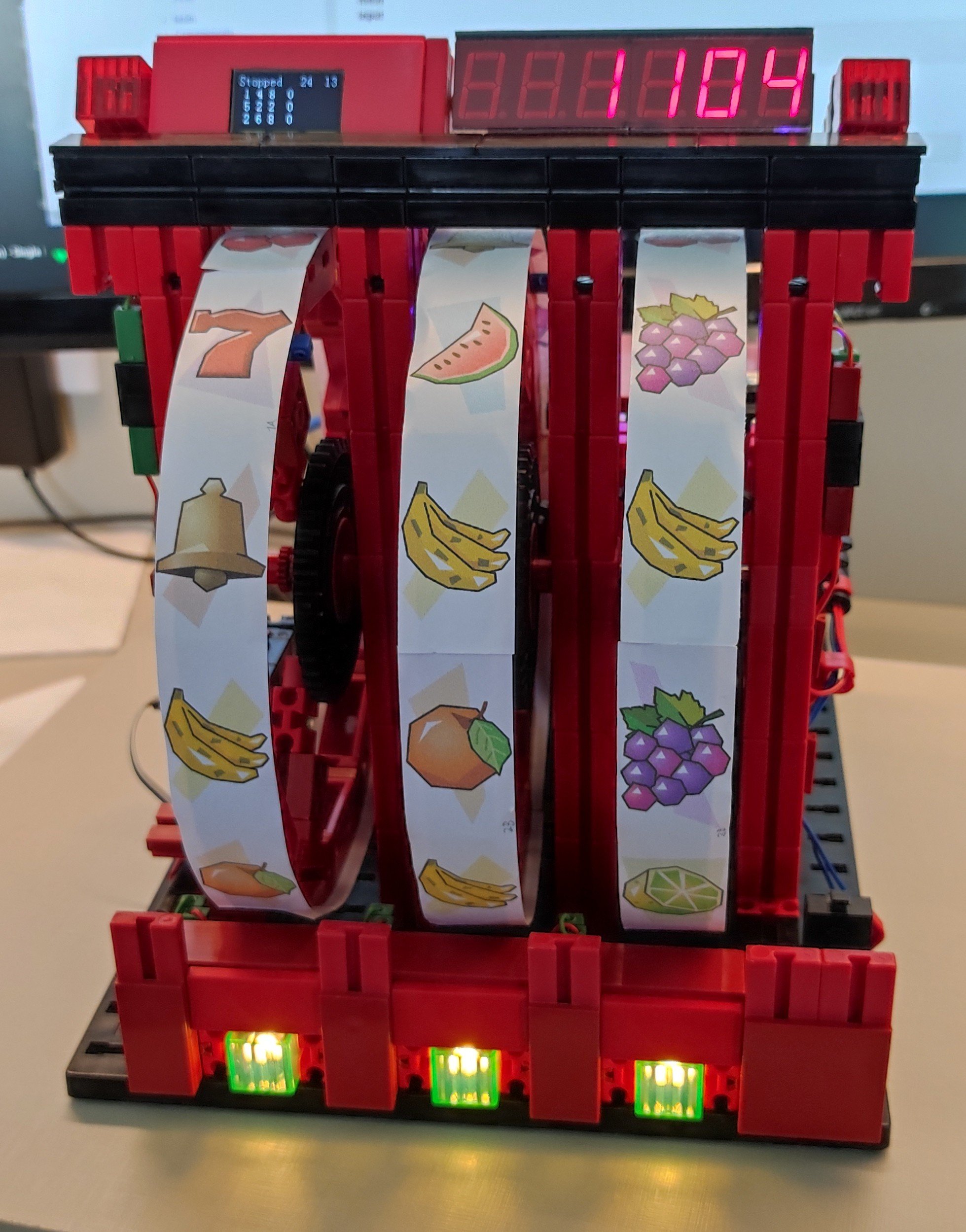

So here it is... A slot machine. 🎰 After a while I realized that keeping the project as a secret is a bit silly. :? The hardware problems are all basically solved now, and I ended up using a fair share of the Mega's I/O ports. Here's a picture showing the symbol reels and displays:
I had no problems whatsoever with timing and processor speed, I'm pretty satisfied with the Mega so far. But the software is actually more complicated than I thought. Presently I'm refactoring the code so it becomes more manageable (this means classes). I'll post some links to the code and other project documents later in this thread.
After this machine is finished (no idea when) I'll work on a simple project like a basic RC car. ;) My brain will need some rest then.
