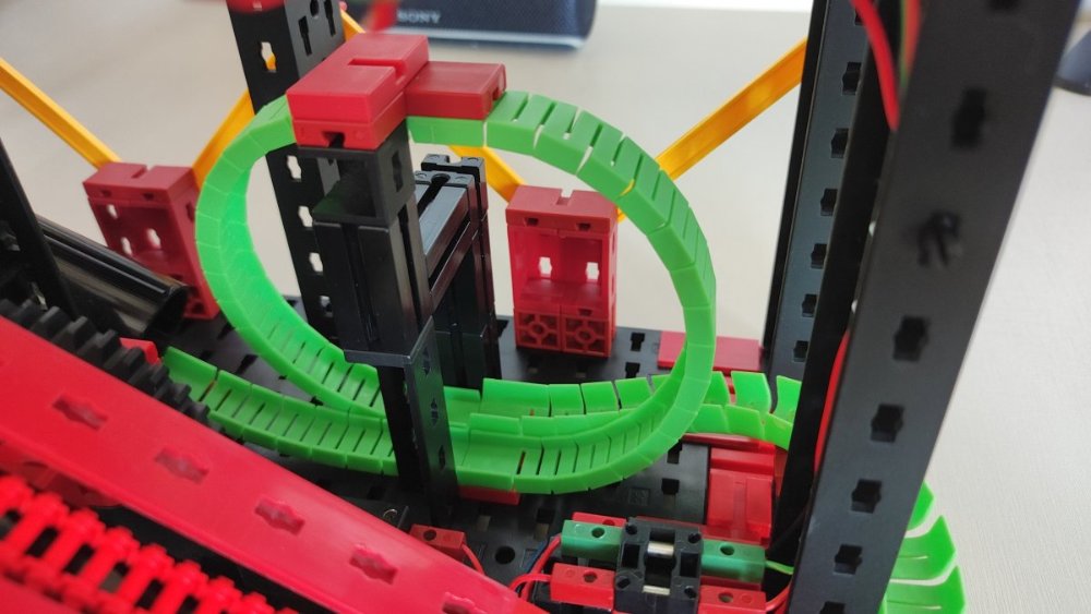

Hello everyone,
I've purchased some ft marble run kits over the past couple of years. After making nearly all models from the original instructions, I wanted to create one of my own, but I ended up with the (questionable) idea of building a "ball roller coaster". Of course it is not an actual roller coaster model, there are no trains or cars... just the ball.
Front view.jpg (102.72 KiB) 3371 mal betrachtet
The ride consists of:
1. Boarding station
2. Chain drive
3. First slow track (8-shaped)
4. Main drop
5. First hill
6. 180° curve
7. Second slow track
8. Double-S curve
9. Drive tire
10. Second hill
11. Two 90° turns
12. Tunnel drop
13. Vertical loop
14. Exit track to boarding station
The model is 77 cm long, 28 cm wide and 36.5 cm high. The total track length is around 5.61 meters and the complete ride takes around 30 seconds (a very short time for so much work :) ). I'll describe the ride in more detail and add more photos and a link to the video in the next post.

Start. A flashing LED indicates standby mode, and the push-button starts the ride.

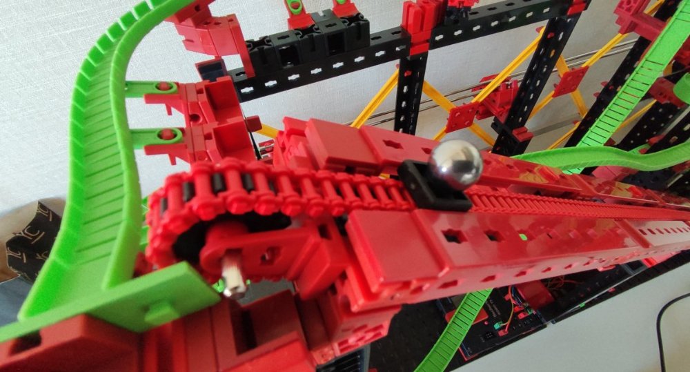

Chain drive. The "passengers" (you'll have to really use your imagination here...) are picked up at the boarding station and pulled via a magnetic holder all the way up. For this I used a mini-motor with gearbox plus an 1:4 reduction and a gear 15 which slowly drives the chain up the incline.
Slow tracks and main drop. When the ball reaches the top, it starts a slow travel through a partial 8-shaped path that consists of four flexible tracks 180 and a pair of 260 mm metal axles, descends the main drop at high speed, then uphill and through a 180° curve. After that, another slow track starts with two pairs of axles 260 and two consecutive S-shaped curves.
Drive tire. Just before the end of the slow track, a luminosity sensor detects the ball. This starts a second mini-motor coupled to a 50 mm tire that rotates at high speed to give the ball a final impulse.
Tunnel and loop. Now the ball goes uphill again, follows two consecutive 90° turns, then is lead directly to the tunnel via a small flexible track 90. The tunnel itself is just a series of seven tubular sleeves which accelerate the ball enough to complete the upward loop.
Exit. Upon exiting the loop, the ball follows the exit track which consists of a high speed flexible rail which leads back back to the boarding station. At this time the lower reed sensor (a non-ft part) should have detected the passage of the magnetic holder so that the chain motor stops right before the ball pickup point. I just need to press the button again to start over.

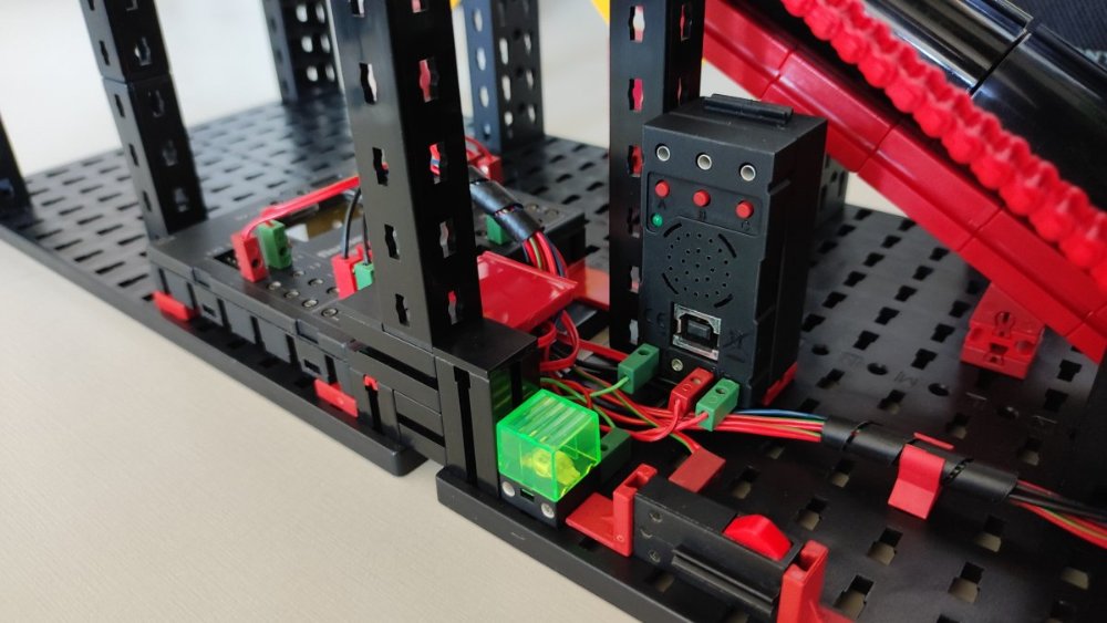

The electronics are straightforward. A TX controller runs a simple program that starts and stops the motors independently. In the whole process I've learned a few things and also ran into several difficulties which I might explain later on.
