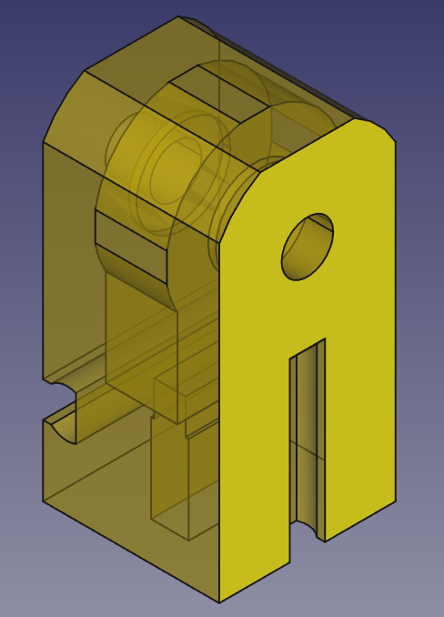

BTW, I happen to be working on a somewhat related 3D print project based on this idea by Richard (NBGer), which I want to use for a robot arm based on my mini power motors.
After finishing this, my idea was to develop a photoelectrical variant of this design which would allow for continuos movement beyond the limited 220° angle of a potentiometer. However, up to now I only planned for single, not quatrature encoding. What is your reason for going for a quadrature signal, when in a motor driven application (which I assume you are planning this for) you usually already know the direction of a turn?
That looks like quite a pretty big project! I wouldn't have the courage to develop now. But I still like to see how other people make something like that.
