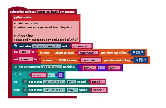

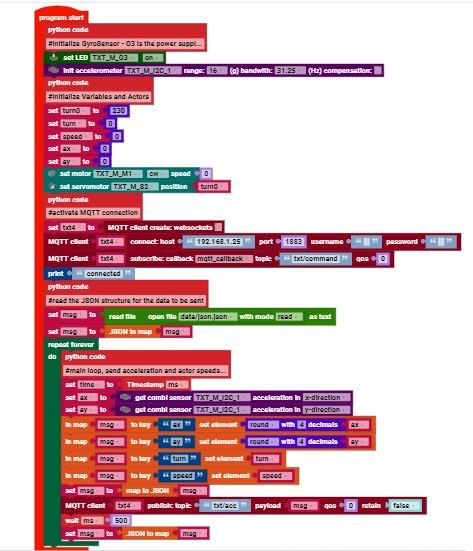

Indeed the MQTT on TXT4.0 is set to port 2883 and bind_address 127.0.0.1, so a connection from another device (without root) is impossible.
However, with the new Blockly elements one can easily connect to a MQTT server in the network like this (here with anonymous login)
The TXT in "MQTT Broker mode" is open and can be used as MQTT server from any device in the network without any problem as You described in another thread. So rather than setting up a Mosquitto MQTT server on a PC or a Raspberry PI - if one has a TXT - one can simply put that in MQTT Broker mode and have fun with communicating between them or any other device in the network.

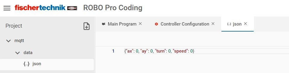

What I personally found difficult was the definition of the JSON message structure just using RoboPro Coding without Python commands. The only way I found is through file. A very simple one e.g. like this:
For receiving information, one can work with JSON messages like this in a call-back way:
As long as working without UTF coding, one can do message sending and receiving without a single line of Python.
From my point of view, even after almost two years, the fischertechnik documentation of RoboPro Coding is far from the level that had been reached with RoboPro. I have read about the idea to create a WIKI and I consider it a great idea...
