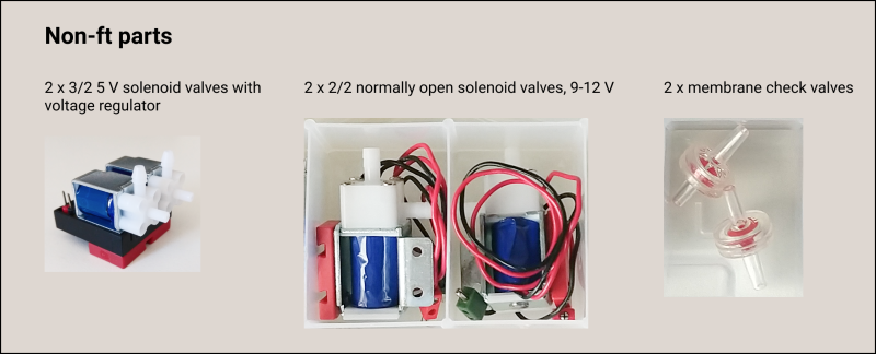

Hi everyone,
I'm assemblying a pinball table similar to the one in the Electropneumatics kit. This project has some challenges for me, the main one being that I'm a complete novice on pneumatics :shock: But thanks to you guys, this forum and the picture pool, I've been able to understand enough to get it working so far. The model is not identical to the Electropneumatics kit because: 1) I don't own the kit itself; 2) Some pneumatic parts are the classic Festo ones and 3) Some parts are non-ft, see here:
The two small 3/2-way 5V solenoid valves behave similarly to the ft ones. I've included a voltage regulator on each and now I can operate them from 9V. They work well with the TXT or directly via a push-button. I'm also using 2 membrane check valves (shown above) between the compressor and the solenoid valves so that each one has its own separate air reservoir (a blue cylinder). I'm not using the big 2/2-way solenoids for now.
I don't have any red pneumatic cylinders, so I'm using an old 45 mm Festo cylinder with spring for one flipper. It works well. For the other flipper I used a leaking Festo cylinder 45 which I've pried open (someone already did it in the past, it had a lot of glue), cleaned it up very carefully, inserted a (different) spring and sealed it back with hot melt glue so I can work on it again if necessary. It has good performance, but it extends a bit less because of the different spring. Playable, but not great.
I'm still experimenting with cylinders. I took a very stiff blue cylinder, pried it open and removed the gasket/O-ring so it became a single-acting cylinder, and runs much smoothly. Then I inserted another spring in it and sealed it with hot melt glue, so it became a "red" cylinder. However the spring is too strong, so it requires extra force and the movement is too slow for pinball.
What I really want is to be able to extend and retract the cylinders pneumatically. This way I could use cylinders without springs, which would be ideal for maximum force. I learned that this can be done using an extra 3/2 way valve for each cylinder, but I don't have them, my pneumatics inventory is quite modest. I have two strong 2/2-way valves (see above), two air tanks, some old Festo valves and Festo actuators. Is it possible to accomplish this with the parts I already have?
Thanks a lot in advance for your help and patience with this "pneum-newbie".

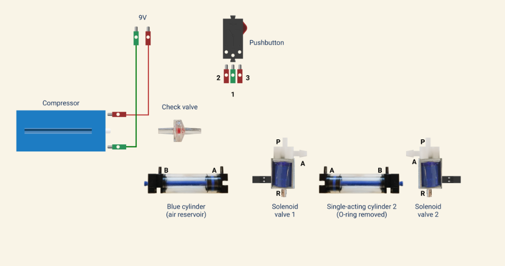

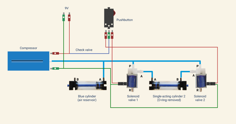

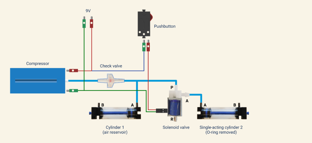

I'm back to the experiments with pneumatics for my pinball table. I feel more newbie than ever :cry: I supose I understand that a conventional circuit (e.g. from the ElectroPneumatics kit) should be like this:
Conventional circuit.png (84.87 KiB) 7600 mal betrachtet
(I intend to use two check valves so the air reservoirs are independent for each flipper, I hope it makes sense.)
However... The only springed actuators I have are two old 45 mm Festo ones. The springs reduce the power and the actuators don't really don't go back to the start position, that's why I want to use pneumatics to move the actuator back. I've removed the O-ring from a conventional blue cylinder so it became a single-acting one. I've inserted a spring in it but it also didn't perform well. By removing the spring it becomes quite powerful:
Incomplete circuit.png (85.3 KiB) 7260 mal betrachtet
Of course this circuit only goes forward, so I've tried this:
Failed circuit.png (104.81 KiB) 7600 mal betrachtet
It goes back and forth, but it's ridiculously slow in both directions. Of course this is not what I need. I suppose that once I get it right, I'll want to move the actuator back just for some half second or so, then turn off both solenoids. Anyway I need your help here! I've even created an empty circuit with labels:
Empty circuit.png (101.79 KiB) 7600 mal betrachtet
Thanks for any help,
Rubem
P.S. I'm giving away my personal collection of 2-D ft parts as a prize for those who help me find the solution :D :D
Zuletzt geändert von rubem am 22 Jun 2021, 18:44, insgesamt 1-mal geändert.

Hello Rubem!
I would say your circuit is perfectly correct and just wonder why you connected the right valve *before* instead of after the check valve. Why not put both behind it? What is the sense of the check valve? You may as well just remove it, I guess.
Good luck,
Stefan

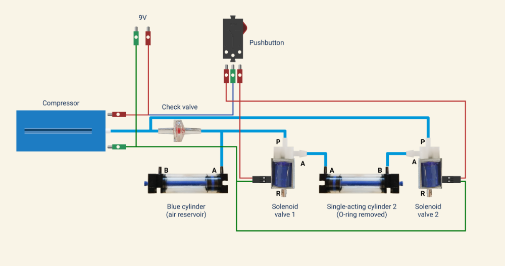

Beitrag von rubem » 21 Jun 2021, 15:08
Hi Stefan,
steffalk hat geschrieben:
21 Jun 2021, 09:24
Yes, the check valve is optional at this point. The idea is to create two separate air reservoirs, one for each actuator. I've already tried it like you say (below), but the results were the same: the actuator moves slowly in both directions.
Failed circuit 2.png (99.78 KiB) 7494 mal betrachtet
Thanks,
Rubem
Benutzeravatar
steffalk
ft:pedia-Herausgeber
Beiträge: 1952
Wohnort: Karlsruhe
Kontaktdaten:
Re: Fragen und Experimente zur Pneumatik / Questions and experiments with pneumatics
Beitrag von steffalk » 21 Jun 2021, 15:26
Hello Rubem,
this sounds strange to me. Could you please try
- leaving the air reservoir away entirely,
- use a larger air reservoir (one of the fischertechnik parts) and, more importantly, feed the air into the reservoir from one side and use another pin as output (not possible with a cylinder), or, finally,
- double check everything for leakages, check that the compressor is running with 9V.
As this is one of the most simple setups you can use a cylinder with, this should run absolutely fine.
Regards,
Stefan

Beitrag von rubem » 21 Jun 2021, 15:49
Hi again,
Thanks for the check list!! My answers:
1) leaving the air reservoir away entirely: Didn't try that, I will.
2) use a larger air reservoir (one of the fischertechnik parts) and, more importantly, feed the air into the reservoir from one side and use another pin as output (not possible with a cylinder): Will do, I have a pair of old blue air tanks.
3) double check everything for leakages: there is an expected leakage from the B inlet of the actuator, since I removed the O-ring. Other than that, I believe I've checked the connections several times.
4) check that the compressor is running with 9V: Yes, it is connected directly to the power source, a 9V / 3A switching adapter.
As a reminder, I'm not using fischertechnik solenoid valves, but the miniature 5 V valves shown at the first picture above 👆🏻 on the left. They are rated at around 0.5 bar. Maybe that's the problem?
Thanks again!!!
Rubem

Hello Rubem,
Can you use a fully intact cylinder? Leakage, expected or not, is no good ;-)
This may be a problem as well as it may not be a problem. Could you try the hand-driven black/blue valve https://ft-datenbank.de/ft-article/3225 to test? Connect the compressor to the middle pin and the pins of the cylinders to the other two.
Regards,

Hi rubem,
your circuit switches both solenoids at the same moment. When one feeds pressurized air into the cylinder the other one just starts to leave this pressure out to ambient. The differential pressure across the piston is less than you might expect, and thus the resulting force that moves it. Could you take a second pushbutton and try this, please:
One pushbutton powers valve 1 (and if this is powered, the air is guided into the cylinder, otherwise the cylinder is conected to ambient). Then you release this pushbutton and without force to the piston the cylinder stays were it is. When you now power the opposite valve with another pushbutton this will feed the cylinder opposite side with pressure and this time there is no high pressure that needs to be pushed out while the piston moves also. Maybe this speeds up your cylinder movement? But I am not sure if all the hose, nozzle and solenoid valve holes have sufficient diameter to allow for large volume flows at low pressure loss. At least you might want to kepp all air connections (hoses) as short as possible to minimize dead volume.
But what do you intend? A kind of pneumatic catapult to shoot one steel ball into the flipper? Check the basic physics behind, to figure out what speed the piston needs to move and then how much pressure it would take to accelerate this complete mass against the coulomb drag of the piston. I have the feeling that ft-pneumatics might not fit this bill. I once tried to shoot a ping pong ball up an inclined track using "Betätiger" https://ft-datenbank.de/ft-article/3218. Well, the Betätiger responds way faster to pressurization than a cylinder but for me it was no success, although.
Regards

@Stefan, yesterday I disassembled my previously opened cylinders (both blue and Festo types) and oiled them with silicon oil again. Especially the Festo one became amazingly smooth, but after just one day I can see the oil is not so effective. Perhaps this is not the right one? The local drugstores have something called "óleo mineral" (mineral oil) which is used for dry skin and... constipation. Is this the one I should try? Consipation makes a lot of sense, hahaha :D :D :D
@Harry, I experimented with the setup you suggested (thanks for the idea!), using a separate switch for the second valve. You are right, the forward movement is much faster if the valve are not operated simultaneously. It works well if switch 1 is pressed for a very short time, but the speed to move the piston back is much slower after pressing it around one second or more. It this case it generates an audible "pfffft". It seems more pressure builds up while valve 1 is open. The natural next step here would be to code this behavior with an Arduino, maybe adding a reed sensor to detect the moment where the cylinder is fully extended and limiting the time valve 1 is kept open.
My pinball table is quite similar to the one in the Electropneumatics kit and has the same size. The steel balls are identical to ft's (12.7 mm diameter) and I suppose they weigh just the same. (Edit: the seller just answered me, it's around 8.4 g.) However I don't have the original valves, cylinders and hoses (I'm using 2x4 silicon hose). The hoses between the valves and the cylinder are around 10-12 cm, that's much shorter than in the Electropneumatics kit (30 cm).
